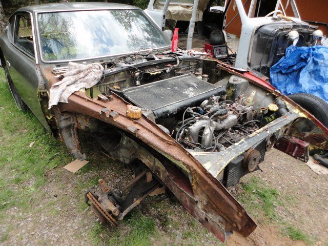

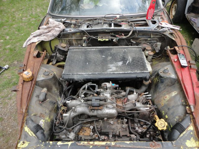

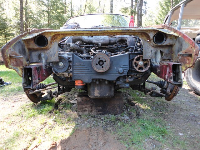

  4. Thanks for the pics, I did think of flipping the intake around but I think it will hit the hood, the STI hood scoop for sure, see this pic, the rad could sit lower like this with fans on top, still room for the twin turbos on the sides and above the rad. Now if I could find a wide yet short rad it could go up front, but then no room for the turbo intercooler as someone mentioned.
  5. there really is not much room in front of the rad support but ill take it into consideration. here is a pic with the hood on it, everything clears nicely.
  6. The engine is sitting in the same position as it does on any subaru, so I dont think it will matter that it is forward, my only concern is the rear being too light. I had these cars in my yard so I am going with it. the rad location is on hold for now, just trying to get the metal work done, I keep getting bothered by people coming over and asking what the hell am I doing!
  7. I plan to make it for both street and track so I can drive it on weekends to the track, I live like 20 minutes from the Calaboogie race trace. I have the rad sitting in there flat like and it looks cool, I think I will make a brace for the shock towers and incorperate it with brackets for the rad, just got back from the dump with some nice sheet metal for the floors, hopefully get all this welding behind me asap.

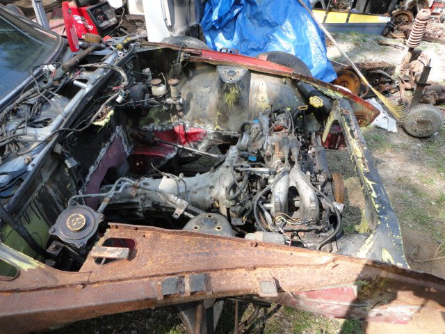

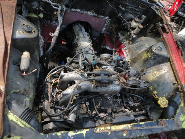

  8. Ok the engine is in for test fit, it certainly is forward! Now if I do mount the radiator behind the motor flat pointing up or down with fans, what way would I want the air flow to go? I am thinking louvers on the hood. I could make it fit in front but very very tight.
  9. I like the idea of having 2 rads, but let me get the motor in and take pics, ideally it should go where it belongs, in front of the motor, if the motor takes up too much room up front then ill consider options with you guys.
  10. You can, just need a sawzall and mig and anything can be done.
  11. Not sure but for now NA, later maybe a twin turbo since ill have lots of room for it behind the engine. I am still trying to figureout where to put the radiator!
  12. I used a 99 Subaru Forester, lol I have 3 of them, well now 2 as I chopped up the red one, using the sheet metal from it too, lol Shifter is an easy fix, just have to lenthen the rod so the subie shifter reaches the Zs hole, add the little thingy thing from the subie shifter and it will be done, I do feel like I am cheating here, but its still allot of work, around 30 hours so far, plan to put in a 2.5 Franken motor.

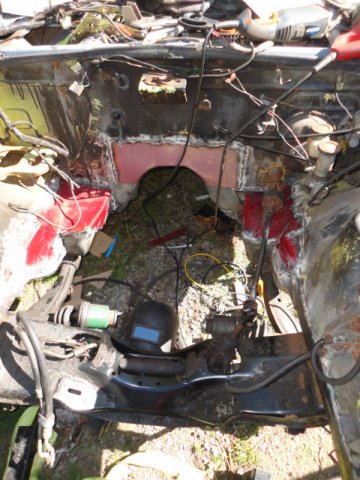

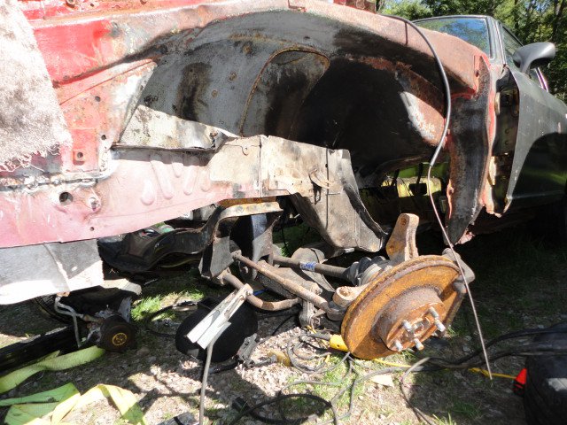

  13. Thanks, I will keep camber plates in mind, , worked on the engine compartment all day, here is what it looks like as of 4pm today. Lots more metal fab to go ( floors) but I am past the hard part. Also lots to do on inner fenders and reinforcing.
  14. Yes welding it together, steering shaft clears fine, engine is forward of it. I need a shock tower that fits right or use the datsun with the subaru mounts. we have nice weather now so ill get some work done.
