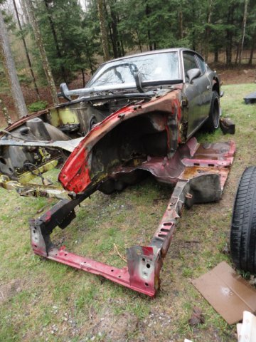

Thanks, I will keep camber plates in mind, , worked on the engine compartment all day, here is what it looks like as of 4pm today. Lots more metal fab to go ( floors) but I am past the hard part. Also lots to do on inner fenders and reinforcing.

Hey guys, I have been busy with other projects but put some time in the Subie Z project this week, here are some pics.

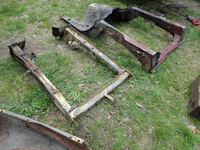

There are a couple reasons I think I need to use the subie rear end stuff, first of all the front end of the subie is about 10 inches wider then the datsun, secondly the front subie hubs have 5 bolts and disk brake, the subie rears also have 5 bolts and disks. I will be using the top part of the Z's tunnel but the lower part of the subies tunnel. I might even just trim off all floors and just use the subies sub frame rails and build the rest myself, stronger i think. I am thinking I will have lots of space behind the engine in the long Z compartment, lots of room for perhaps a twin turbo? Radiator will be tight up front as the motor is a little forward, thinking it could be relocated but not sure where, or maybe just build it in nice and tight up front.

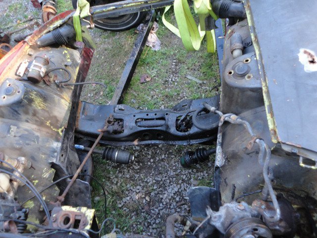

Hi All, I have been tinkering with a idea to make an AWD Z car from a 2000 subaru I parted out and a 72 z I have leftover from a restoration I am doing on another 1970 z. I have already chopped up the subaru, see pics. The idea is to cut out the floor area and weld in the subaru section that will allow me to drop in a subaru 2.5 with 5 speed trans. The rear end of the subie is very simular to the z car's. I would just bolt in the diff and modify the z's suspensions A arms to work with the hubs from the subie. see pics for better idea of what I am considering. My main concern is the weight being too far forward and the rear being too light. I think if I locate the battery and few other things to the rear of the car it might help. Another concern is what will the purists say, but then i think about it and say F$%& the purists this is a hot rod project.
