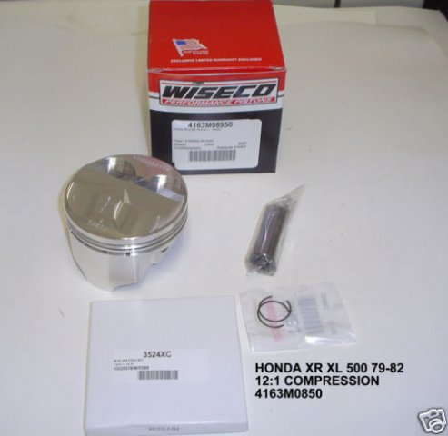

  2. So i was doing my annual research on the stroker kit and landed for some reason in the wiki page. In wich they mentioned that "Without increasing bore size, fitting an L28 with the longer stroke LD28 crank will only result in 2.9L. In Japan and other parts of the world the popular "poormans mod" was the 3 mm~ overbore using the 89 mm ~ 90 mm Honda FT-500 / XL-500 motorcycle pistons along with the L14 rods. The real poorman would use the much cheaper/heavier 89 mm FJ20 or even KA24 engine pistons. All of these were cast pistons and had low endurance and would often fail when subjected to high compression and advanced ignition timing compared to custom forged pistons" So i did i search in here and nothing, looked at my How to Mod.... (the bible for l28 mods) and found nothing. The question is has someone really has done this or is this is another wiki error any input would be greatly appreciated, cause looking at the piston and it does not seem like is hard to find specially with an overbore of 89 and the 90 mm. They sure will be expensive to buy six of them but they really intrigue me as they look really well made. Anyways heres a pic of one of them taken from ebay
