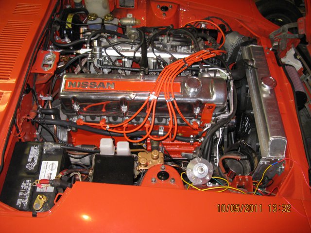

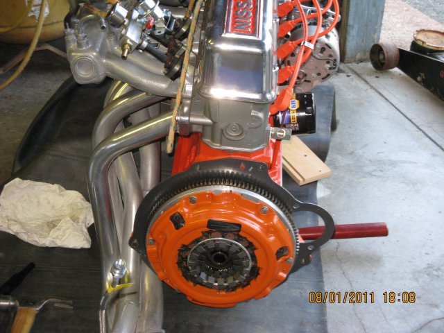

Ld 28 crankshaft, l24 piston rods, arias 89mm(flat head with valve pocket),jdm timing set, N42 head 11/1 Compression,ported & polished,490/290 camshaft,arizona zcar performance oil pan. Engine built in Montebello,Ca.
I know that the stock fuel and ignition system are inadequate and i will upgrade when money allows.I have the timimg set to 15* BDTC and am running 110 octane race gas through 270cc turbo injectors. JSK fuel rail rising rate fuel regulator,60mm TB,cold air intake, and 3 to 2 to 1 header. I will have to look to see what plugs I bought from napa. I have not messed with AFM,I do not own any specialty tools like a vacuum gauge.It is much faster than stock, idle is rough with a lope, I do not want to hurt the engine due to ignorance and the lack of true mechanical training. I have only built and restored Datsun 1600 roadsters in the past. I would love to find a 280z wizard within 3 hours drive who has much more knowledge and tools than I. I found a dyno shop in San Jose(6 hour drive)but cannot get an appointment until May 17th.I am sufficient at brake jobs,clutch work, and basic automotive.
