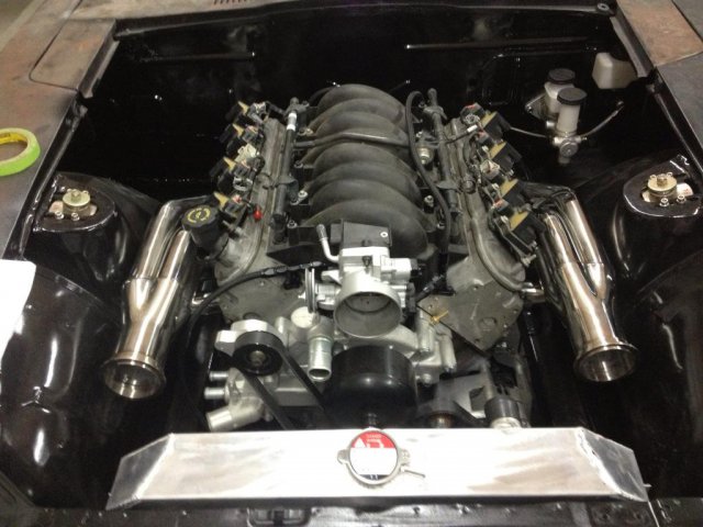

  1. Thanks. Yea as soon as I bolted them on I noticed they needed to be cut back also lol..other than that they fit really well.

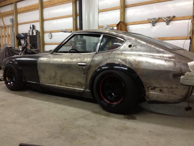

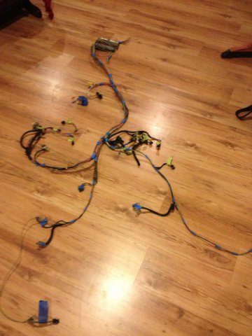

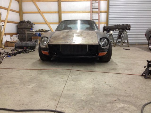

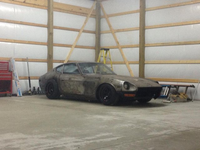

  2. How far did you cut yours ?.. All the way back as far as it could go?
  3. Up and forward turbo headers off of eBay... I'm thinkin serious after I get the engine running about puttin a single turbo on it ..

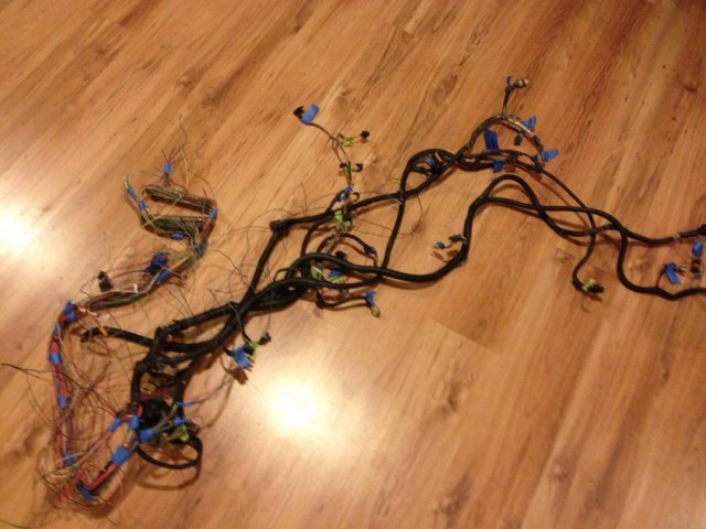

  4. Just giving y'all an update, I have my harness about 85% done, only thing that's holdin me back from starting the engine is my fuel lines!! Getting so close. Also ready for a single turbo in the future!

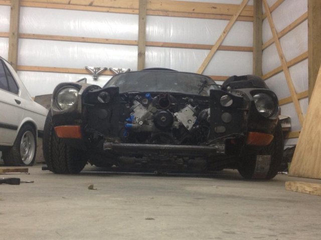

  6. Haha I know what you mean .. But hopefully ill only have to take the engine out one more time to paint the engine bay..

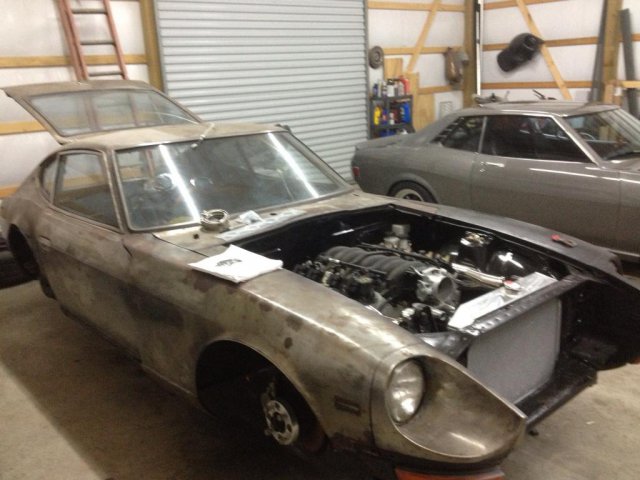

  7. I'm on a budget and I got the motor for 450 complete and the auto salvage place let me have that transmission with it so I will run it til it fails..then I will get a t56
  8. No I'm using the c5 bat wing oil pan ..sits right above the front crossmember just enough so I can build a skip plate

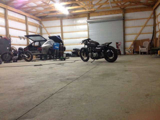

  9. here's a video my brother made of my z with me working on it in our new shop
