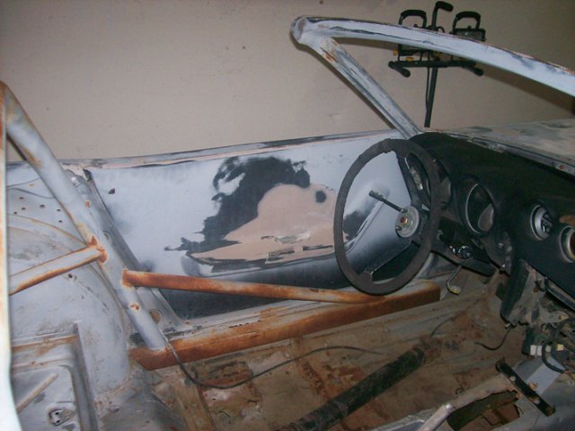

It will be mostly street. I plan on driving it most days. Welding the cage in/through the doors would be interesting. I may have to remove these hollow fiberglass (yeah.. about 5 - 9 lbs each) doors and find some stock doors to place on them. Not sure if the stock ones will even bolt up any longer, but I'll have to check sometime. The idea of welding the stock doors is interesting also, but then I'd have to have a ladder for my wife to be able to get in.. probably not going to happen. Bracing through firewall and front frame rails I am all for. The cage is already welded to the rear shock towers, but I plan on adding a strut bar in the front / back both to further increase the rigidity. I am planning on replacing the floorboards and frame rails. I didn't want to make it look like I was jumping head first into this, but I did want to write it all out and plan it all out so I knew for myself what I was going to do, when I was going to do it, etc.. and to get your very valuable advice about it all. Thanks a ton! Keep it coming.

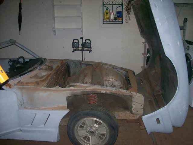

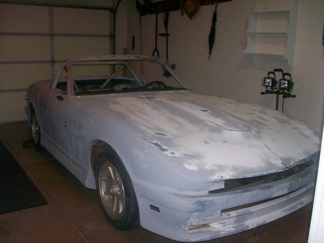

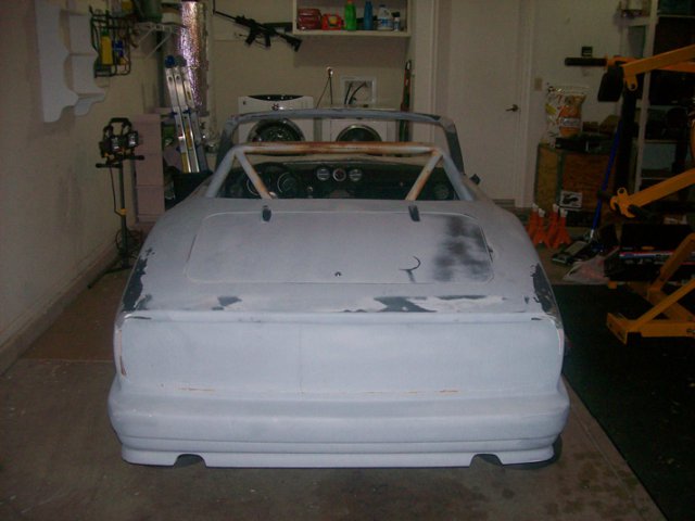

Hey guys.. finally getting around to working on my project car (pics attached). I think I paid about $500 (or less) for the '73 240z , so I figure it was a decent deal. Basically the car was going to be used for a track setup by the previous owner. I'm not sure where he was going with the convertible top, but I do like the bodywork, although it needs some repairing from fiberglass cracking, etc from being exposed to the Arizona sun for an extended period of time. My overall plans: I would like the car to run a 12-13 second 1/4 mile when I do decide to drag it. I don't want anything to break or twist. I'm willing to put a few extra dollars into it to ensure that it does not have issues in the future. Engine plans: ~440hp SBC 383 w/ JCI v8z kit - engine custom built by myself or my dad, or built my a competent engine builder. I'm planning on throwing a FAST EZ-EFI system (TBI) on it for fuel. I've considered a complete MPFI system, but it does complicate things and I've heard nothing but great things about the (quick) auto learning EZ-EFI setup. Drivetrain plans: Built up 700R4 and a R200 Viscous LSD (Q45 3.54 ?) Drivetrain / Suspension / brake plans: Option #1 - Arizona Z Car Track-Pak (Front/Rear -- 7600 $$ wow) , Option #2 - Modern Motorsports Rear Adj Control Arms, Modern Motorsports R200 Mounting Package , Modern Motorsports Front/Rear 13" Brake Package , Option #3 - Techo Toy Tuning R200 Rear End Conversion Kit (http://www.technotoy...0-rear-end.html) I would like your opinions on the above choices.. what would be best and easiest to implement. I would like to do much of the work myself, so the simpler for me, the better. I really like the Arizona Z Car Track-Pak, but it's friggin expensive. So.. after that is all out of the way.. I need to know how to proceed with this car. My first though was to take it down somewhere and have it soda blasted (so it doesn't harm any existing fiberglass). I'd like to know what I am working with before I begin my first attempt at fiberglass repair and fabrication. Is this what you would do first? I was planning on the following "order" for completing the car: 1. Remove dash and have someone soda blast everything we can 2. Repair any fiberglass that has cracks, needs filling in, fabrication for tail light installation 3. Primer it before anything starts rusting 4. Replace frame rails and floor boards 5. Primer floor boards -- Spray or Brush truck bedliner in engine bay and cabin floor of vehicle [edit] 5a. - Reinforce chassis to prevent flexing or have someone else with 240z experience do it (Phoenix area has someone good). 6. Remove old rearend and install new rearend, suspension, and brake components 7. Replace front control arms, suspension, and brake components 8. Install transmission, driveline, and mounting components 9. Ensure steering components are bolted up and functional 10. Install engine and mounting components 11. Install headers and have an exhaust shop install the exhaust 12. Hook up heater components 13. Install new fiberglass + coated dash + gauges Let me know how that looks, and if I am missing anything important. I want this done right the first time Sorry for the lengthy post and might be over-thinking it, but I like being prepared and know what I am in for. Thanks guys!
