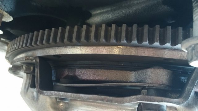

Is this an OEM clutch, and should I replace it?

Here is a pic of the clutch where you can see the thickness of the disk. If the brand is LUK, then I'm guessing its not the original clutch, so I may just swap out the TO bearing and reassemble. I was tempted to install a lightweight flywheel, and have searched through here to see if any/many other people run the LW FW, but can't seem to find much, if any, info either way. -

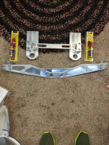

One other clarification regarding the R200 upgrade... I read that I can eliminate one of the lower brackets, to make room for exhaust, if I use the Ron Taylor mount with the red Urethane trans mount. Is that true, and if so, which bracket in the following pic would be eliminated?
I should have about 24.7" diameter rear tires, so I think the 3.90 should be a good ratio based on what I'm reading, and what you guys are stating. Probbably just stick with that for now. I took some pics of parts, along with some questions I had. I had posted another thread about the clutch, asking if Luk was the factory clutch in the Camaros, and wondering if I should be fine leaving the factory clutch in its place. I have a list of "well I'm in there so lets just replace it" and was thinking of putting a lightweight flywheel and a clutch kit in while its apart, but also just thinking of leaving the stock clutch and flywheel to save a bit of money for now. Here is how much material is left on the clutch disc. Pic of the R200 upgrade parts I picked up (Billet Z Cars stuff is in the mail, should arrive by Friday): Here are the sway bars. The rear one has Suspension Techniques sticker on it, but the front one I measured at about .78 inches, so not sure if that is just a factory sway bar, or Suspension Techniques, or ??? LS1 Engine swap (cleaned up nicely, no oil leaks that I can see). I pulled the A/C bracket and compressor, motor mounts, exhaust manifolds, and EGR, so its almost ready for header and motor mount brackets install. I have almost all of the brake and suspension parts here. Just waiting on the TTT rear LCAs to show up, and the Ground Control coilovers are still in one of the bins: Found one of these Grant wheels to install... not sure if we will keep it tan, been looking for a shift knob that is at least close in color, if I can't find one, I'll have the wheel painted black to match the current shift knob. Finally, something interesting that came in the 240, it is a dealer installed air conditioner. Was thinking of using it, but I would need a condensor for in front of the radiator, a receiver/dryer, custom hoses, and probably run the A/C setup from John's Cars, as it seems to be a way to install the A/C Compressor and not hit headers, mounts, etc. Curious if anyone has seen one of these A/C units in a 240Z?

So I am at the point of checking parts on the ls1 before I install it into the car, and trying for a healthy balance of replacing what is necessary, but not getting caught up replacing everything and never getting the motor in the car. I split the engine and trans yesterday, and from what I can see there is some sealant between some of the seams of the trans case, so it looks like someone has been into the trans at some point. So I guess I'm hopeful the clutch was replaced sometime since new. Upon looking at the clutch, I can see that its a Luk clutch, so I wondered if that was factory. The disc looks to have ok amount of material left on it, less on the flywheel side, but still seems ok. The throwout bearing feels pretty dry, so at a minimum, I will probably replace that. So, is Luk the factory clutch, trying to determine if the clutch is original to this engine that has 100k miles on it, and are most guys swapping in a new clutch and flywheel so as to avoid having to do it in the near future?
