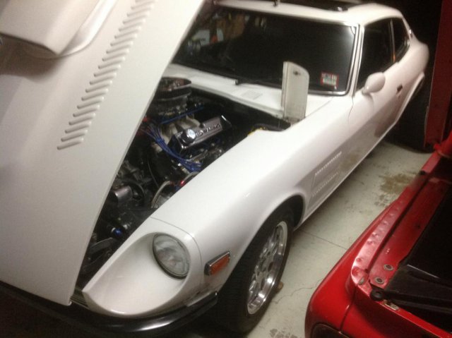

  3. Car has run a best of 11.5 at 118mph with full exhaust and street trim

  5. Hi I am new to this forum but have found a lot of information on this site to be very helpfull.Basically took my car to the local dragstrip and on my second launch snapped the factory moustache bar.the car is a 1976 260zed 2+2 393 cube windsor,c4 auto 3800 histall,r200lsd 3.9 gears.Basically everytime I take it to the track the weakest link breaks and now im up to the moustache bar.Can anybody advise me on a stronger option.Thanks
