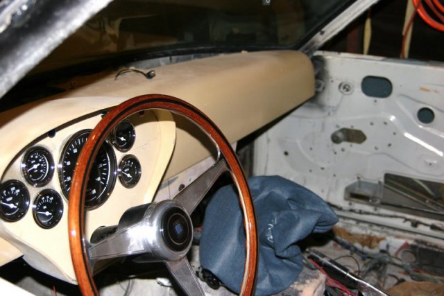

I've sold my last two dashes. This one is for me. I'll finish cleaning up a few areas then paint it wrinkle black, both the face and body.

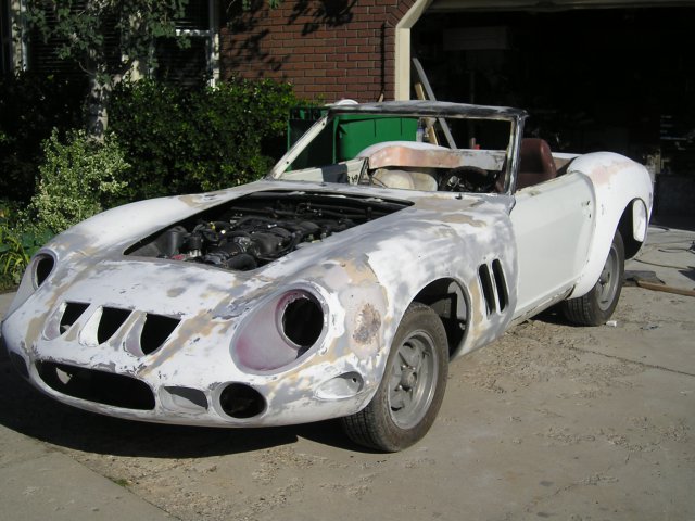

Wow, how time flies by. It has been a good four years since I really spent much time on my GTO. This past week I extended the front fiberglass section just over 4" to match the 280Z extension I did some time ago. I also recreated the top three air scoops. I also finished cutting out an aluminum face plate for my fiberglass dash. Over the next two weeks my goal is to have the body finished.
To attach the fiberglass hood to the metal frame, I used Fusor 147 made by Lord. Used by Ford and GM, I highly recommend it for any fiberglass to metal bonding applications. For the hood hinges, I found some pictures of the original hood hinges and replicated those. The hood relaxes about 15 deg. from vertical when open. Next I am cutting out the pattern for the radiator cap feature. I'll put you down for some hood scoops and bonnet hood latches.

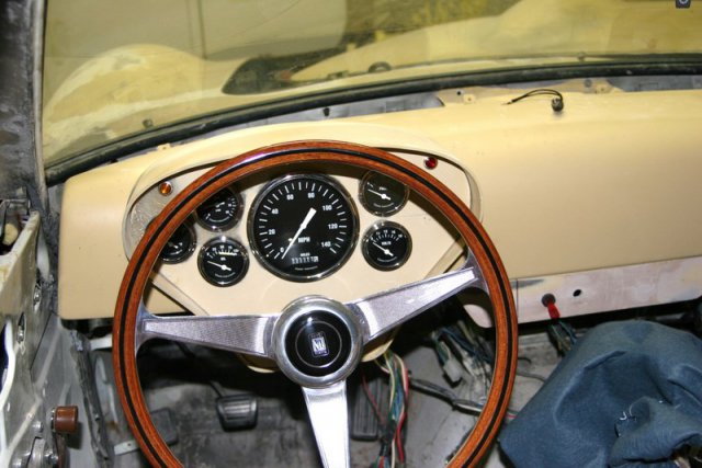

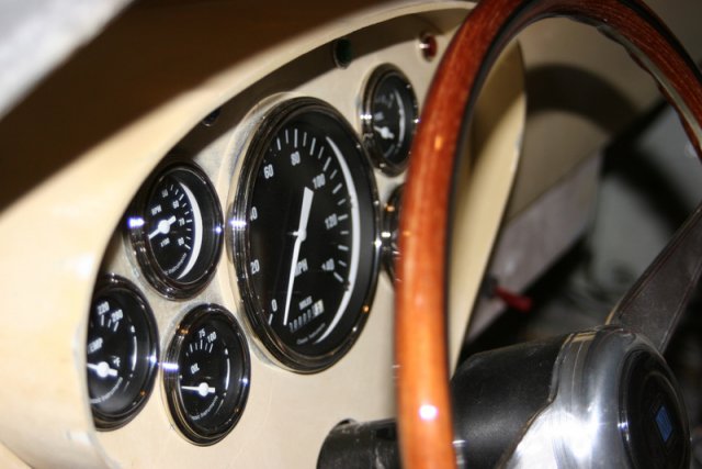

I have been looking around for the right gauges that have the vintage race feel as well as gauges that resemble the original six gauge layout - one large gauge in the center and five smaller gauges. I decided to go with a 5" speedo in the center as opposed to the tach and five 2.25" smaller gauges. I drilled the holes and mounted the gauges in the removable Nacelle. Its taken me a lot of time to finalize the dash and gauge setup but I am happy with the results. Here are some preliminary photos of the fiberglass dash, gauges and Nardi steering wheel. I will be painting the dash crinkle coat black. I will also have a switch panel as seen in the pics which hangs from the dash. This panel will have the key ignition and various toggle switches. The only column switch will be the turn signal. The next step is to finalize the heater/fresh air dash vents. I took the car for spin the other day. That LS1 really moves!
I recently finished a dash that replicates the original GTO dash. The design allows a removeable Nacelle and faceplate as well as the same gauge layout as the original six gauge layout. I used the datsun dash frame in the design, so you can use the old datsun frame to mount and secure the dash. In the process I created some fiberglass molds so I could make a few extra. If anyone is interesed let me know. I'll post some pics within the next few days. Thanks for the comment Chelle. I just won a small victory! Jan. 2 I waited in line at the DMV early in the morning to get a specialty construction registration pass so I can register this car as a home made car in California and so I will not have to pass the CA smog regulations. CA only issues 500 passes per year to the entire state of CA! I desing Garrett Turbochargers for my day job and I am thinking of turbocharging this LS1!
Zerrari, Sorry if I wasn't clear in my post. I made the fiberglass body from molds that my dad had. The more I look into it - it seems that the body molds were made from the alpha kit. There were a few things I wanted that the alpha kit lacked. So I created an oval mouth, smaller circular air vents, bottom air scoops and centering the fog light locations. It has taken some time, but it coming together.
I've modified the front end of the body to include an oval mouth opening, ground air scoops and smaller circular brake cooler vents. Six weeks later and this is where I am. The before and after pictures are included. I am pushing to get this project wrapped up this summer!
