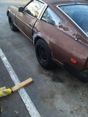

	I chose to do this swap because I had the parts, and my stock differential was shot, and I broke a stub shaft.
	The infiniti brake calipers are far superior to the 79zx calipers, the infiniti rotors are dimensionally identical, but use a drum style emergency brake.
	The infiniti differential is 3.9-1, the stock is 3.7-1.
	It widened the rear hub to hub by about 2”.
