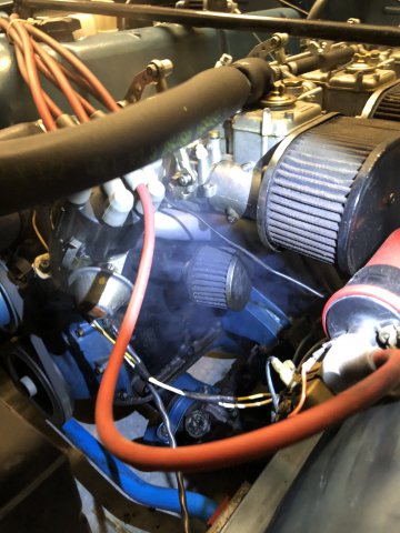

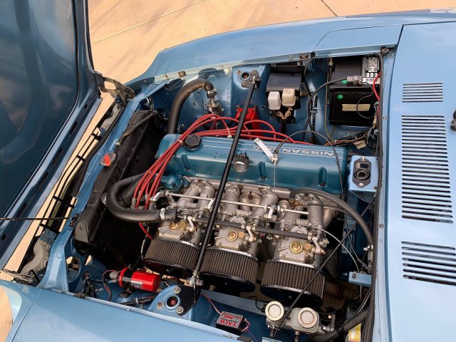

Newbie

  3. Thanks for the reply Silverado. That's my dilemma; am I overthinking? Do I try to recirc the gas or address a possible nonexistent problem? I guess I downplayed the amount of smoke a bit... it does come into the cabin and rises from the hood so its more than wisps. I will run the compression test tonight and report back. Thanks all!

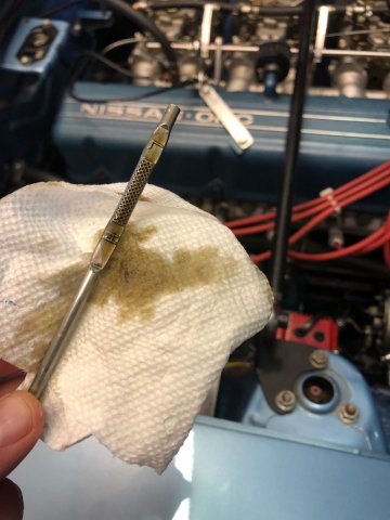

  4. Checked oil. Can’t really say it smells like much of anything... maybe a little like fuel.
  5. My buddy has the gauge so he is going to stop by tomorrow and we will run a compression test. The only smell I get is fuel... I will check the oil. No issues with coolant and operating temps / oil pressure / etc all read normal on the gauges. Thanks for the reply!
