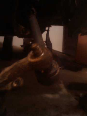

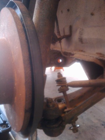

Thanks for all the advice guys... Here's the deal, I went to my friendly local autozone and borrowed a "pitman/tierod end remover" its currently (rod end 1) (remover 0) this thing is on there... I plan on replacing this stuff but Im not sure what I need to save... so far I just removed the suspension minus the strut tube bottom/steering arm. tried to take a better picture, but my camera is dead and my phone sucks. thanks. -
Hey, Here's my problem... I'm removing my front suspension and have everything disconnected, except the tierod. I removed the cotter pin and castle nut. However, it still wont budge. Am I missing something? I know its something stupid and I'll feel like a idiot, but I can't see what it is. thanks in advance, Murph'
