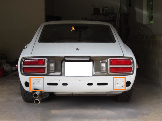

SUNNY Z Posted February 23, 2012 Share Posted February 23, 2012 (edited) Alright, I'm in the process of building my 280z, and trying to eliminate unnecessary weight along the way. I'm going to be shaving the rear bumper soon. As i was under the car yesterday, I saw two brackets that have to weigh 2-3# each. The bolt holes can be seen through the rear sheet metal, in the orange boxes below. I was curious if they actually do anything, because they have one bolt to the frame, and then look like they might be spot welded on as well. I don't really see the rear "bumper" losing much structural integrity if i take them out. I was just curious. This is not my car, just a generic pic. Edited February 23, 2012 by SUNNY Z Quote Link to comment Share on other sites More sharing options...
gearheadstik Posted February 23, 2012 Share Posted February 23, 2012 They are used to tie down the car during shipping.. There was a external piece bolted there when new.... Quote Link to comment Share on other sites More sharing options...
SUNNY Z Posted February 24, 2012 Author Share Posted February 24, 2012 They are used to tie down the car during shipping.. There was a external piece bolted there when new.... ah! thanks. out they go then! Quote Link to comment Share on other sites More sharing options...
piston Posted February 24, 2012 Share Posted February 24, 2012 Mine actually came with the original tie down bracket piece bolted on there when I got it. It is also the same spot for the skinny bumper mounts if I'm correct. But if you are planning to shave it, all of the holes can be patched off and will not effect your rear structure. if anything, I would think stiffer and stronger. Quote Link to comment Share on other sites More sharing options...
