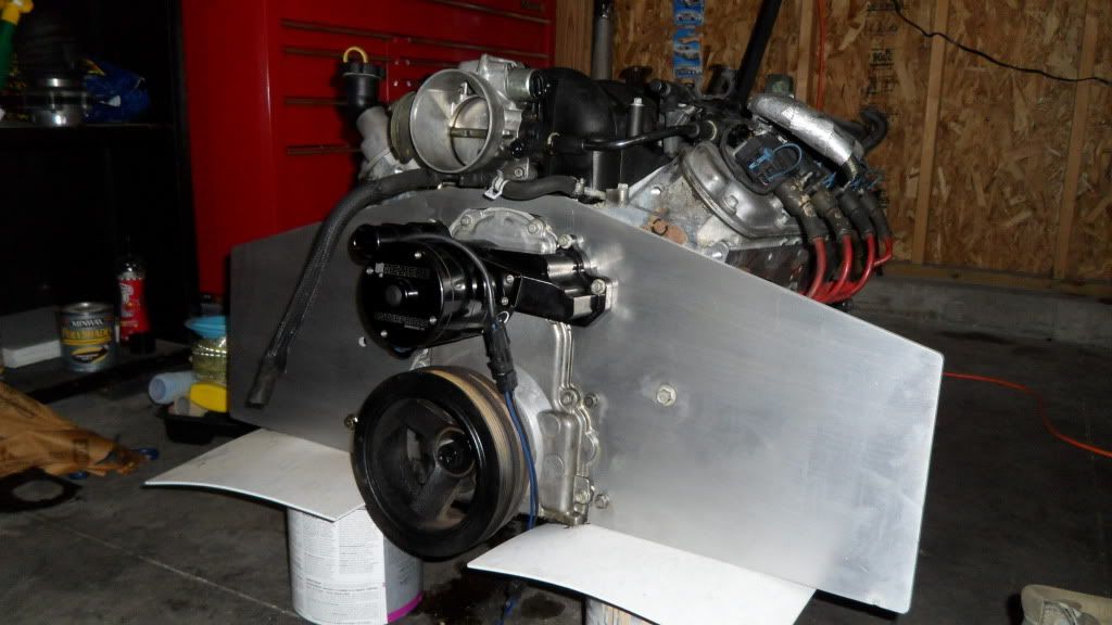

A couple of update pics. Cutting the firewall soon. Also bought a new beefier front motor plate and a mid plate. There is a place in Fargo that Im going to have make me some custom long tubes. Im picking up a set of 241 heads and having advanced induction cnc port them and make me a custom grind cam. Also looking at a Fast 102 intake with a 102mm throttle body.
