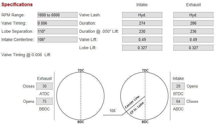

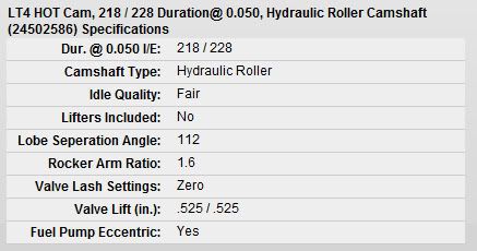

boggero Posted September 9, 2012 Share Posted September 9, 2012 I have 2 engines available for my 280z but I don´t know which one would be better for 8 pounds of boost. The one I am running right now is an old SBC with Vortec heads 1.6 roller rockers antipump up lifters Dish pistons :doh: lol XE 274 cam Fluid damper The second choice is a stock LT1 with only lt4 hot cam The sbc needs to be refresh and would like to put a high volume oil pump and probably change the dish pistons. the lt1 doesnt need anything at all What would you guys do?? Help! Quote Link to comment Share on other sites More sharing options...

boggero Posted September 9, 2012 Author Share Posted September 9, 2012 Would it be a real difference in performance with a turbo with the xe274 vs the lt4? Thanks in advance!!!!! Quote Link to comment Share on other sites More sharing options...
dexter72 Posted September 9, 2012 Share Posted September 9, 2012 What size small block?. Dont use it if its a 305. If its a 350 use that and do some research to find out what compression ratio works well with those heads and a turbo. You may want to change cams also so check Quote Link to comment Share on other sites More sharing options...
boggero Posted September 9, 2012 Author Share Posted September 9, 2012 It is a 350 I am pretty sure about it but I don't really want to change the cam to a boost one because in 2 weeks i have to take the car to the muffler shop to do the turbo exhaust and since I am in mexico it would take like 1 month for the new cam to arrive Quote Link to comment Share on other sites More sharing options...
boggero Posted September 9, 2012 Author Share Posted September 9, 2012 Do you think the lobe center of 110 of the xe274 would affect the spooling time of turbo? Quote Link to comment Share on other sites More sharing options...
