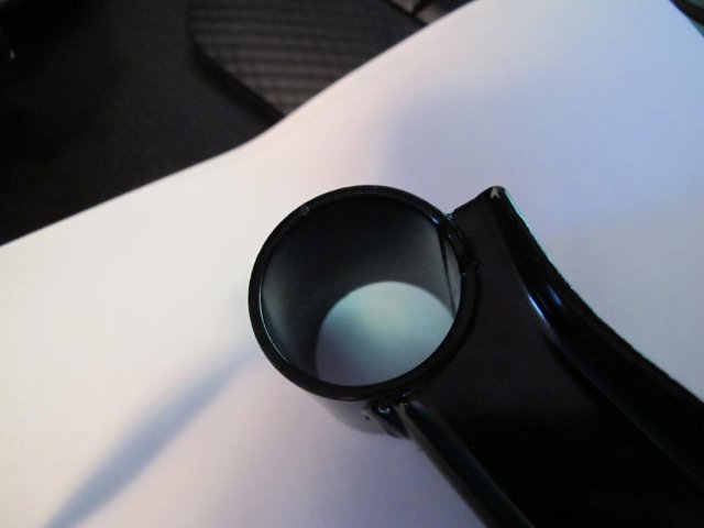

takayuki Posted February 15, 2013 Share Posted February 15, 2013 Hello, I decided to replace the old rubber bushings with urethane ones from blackdragon. So I melt out the rubber with a torch, then i used a hacksaw to remove the sleeve that was left inside. I go on to install the new urethane bushing and they are loose! Very loose! Was I supposed to not remove the old sleeve inside? Because It seems that way..... Or do I just have a bad part? Quote Link to comment Share on other sites More sharing options...

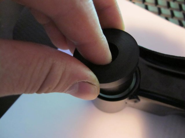

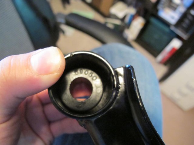

takayuki Posted February 15, 2013 Author Share Posted February 15, 2013 one more picture.. i hope you guys understand what i mean Quote Link to comment Share on other sites More sharing options...
takayuki Posted February 16, 2013 Author Share Posted February 16, 2013 neeeevermind. Found my answer.. I was supposed to NOT cut out the sleeves... argghhh!! Quote Link to comment Share on other sites More sharing options...
