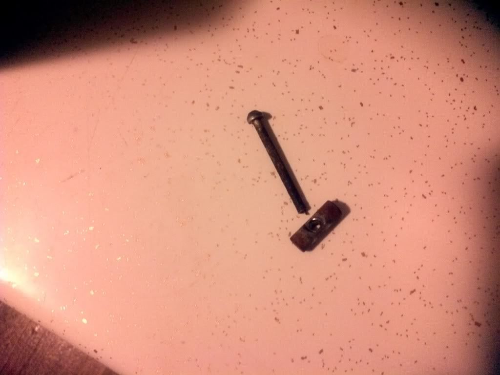

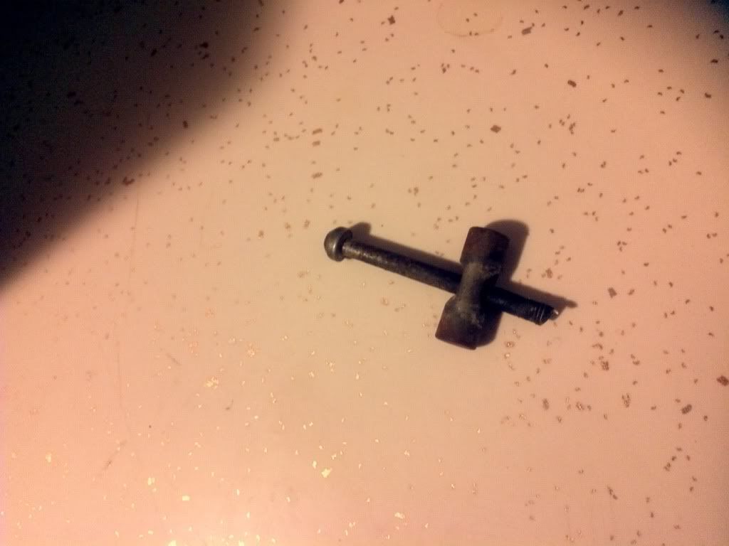

Hey guys I just picked up a 74 Datsun 260Z a couple of weeks ago with a sr20det swamped into it. I'm loving the car and this forum (so much to learn I'm a noob). When I got this car the previous owner told me the E-Brake adjustment bolt had broke and gave me the broken bolt when I picked the car up. Nothing is listed on blackdagonauto for adjustment bolt but it looks like the trunnion pin on page 56. Is that what this is?
Looks like it's the item under part 19. It has no number, so it's probably NLA. Any bolt will likely work in it's place. It's probably an M6 thread? All you need to do is figure out an appropriate length. I may have one at home I can measure.

Sorry it's taken me so long to get back to you. I just found my spare parking brake assembly. That bolt is an M6 thread. It's 77mm long. It might be hard to find an M6 that long. But a 1/4-20 x 3" button head cap screw would likely work in it's place. That might be easier to find.
