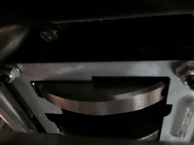

Savage42 Posted February 11, 2015 Share Posted February 11, 2015 (edited) It is a fairly easy install, it's just that the scraper is a close tolerance fit and the holes in the scraper allow for enough movement to center it evenly, but also allows for it to hit if not aligned properly, so not just a bolt on & go deal. After I got my acraper, I told the guys at Improved Racing that the front 2 nuts that are required to fasten the scraper in LS motors running the F-body motor/pan are not in the motor since the windage tray goes from cylindes 3-8 and not the front 2. The cool thing is that the guys at IR are now including the 2 nuts in with the scraper, so you don't have to go out & source them. I got the nuts a few days later (from them) and put it in. The key to install was to just snug down the back, middle and front sets of nuts, rotate the crank and check the gap at each spot where the crank is at the scraper, tap it to make small adjustments (front to back) and once it's clear for each rotation, I cranked down the front nuts to hold it in place, reinstall the windage tray & pickup and put the pan back on. Pretty straight forward and I didn't have to do any grinding or adjustment to the scraper itself. Hope that helps. Edited February 12, 2015 by Savage42 Quote Link to comment Share on other sites More sharing options...

dreco Posted February 19, 2015 Author Share Posted February 19, 2015 (edited) whew.. Got it installed last night. Pretty straightforward. It was a pain to get to the front 2 bolts, but a 10mm ratcheting wrench made it easier. Pan will slide down and back pretty easy. Edited February 19, 2015 by dreco Quote Link to comment Share on other sites More sharing options...
