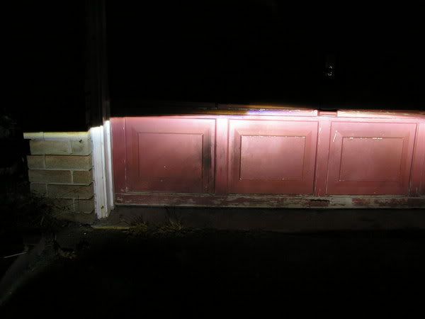

example of cut-off, if you've ever seen a S2000 coming towards you, and it flashes you when it hits a bump, that's 'cause you're above the cut-off but he bounced so you were in the full force of his headlights.

Cut-off being exactly how it sounds, where the light cuts-off.
