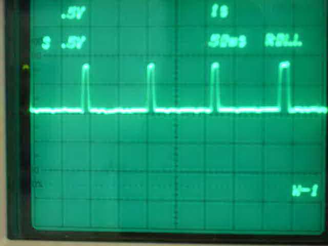

getZ Posted July 25, 2005 Author Share Posted July 25, 2005 well I managed to capture the output signal of the computer to the ignitor. Sorry if I confused anybody last time I posted about this. I thought it was a steady dc voltage. It is a series of pulses and pretty low voltage as well. The attached picture shows only .8volt pulses. I tried another cpu, it was about the same. In technical terms the frequency of the pulse is the errr.. errr.. errrr...errr of the sound of the engine turning over. Every "errrr..." is one pulse. By the way the ignitor and the output of the cpu have to be working correctly if you want to use an MSD with stock style triggering. What the igntor does is pull the "white" wire of the msd to ground at every pulse. Grounding the white manually will give you a nice arc out of the coil. Quote Link to comment Share on other sites More sharing options...
