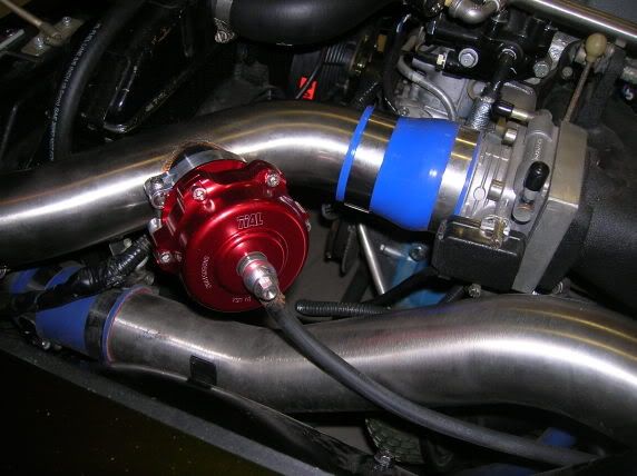

Roostmonkey Posted April 19, 2006 Author Share Posted April 19, 2006 Well, I installed it last night but didnt get the chance to try it out. It was dark when I finished and I'm also in the middle of upgradeing the headlights. Heres a pic to show the install and how sexy it is. Quote Link to comment Share on other sites More sharing options...
Roostmonkey Posted April 19, 2006 Author Share Posted April 19, 2006 Another view Quote Link to comment Share on other sites More sharing options...
73ZCAR Posted April 19, 2006 Share Posted April 19, 2006 Hey Roostmonkey. Nice piping on that install. Stainless? How did you get the bends? Mike. Quote Link to comment Share on other sites More sharing options...
Roostmonkey Posted April 20, 2006 Author Share Posted April 20, 2006 thanks Mike...it is stainless and they're mandrel els cut and welded together then polished to appear as one pc. Took it for a spin tonight and its still bleeding air off at 5-6 psi.Its so loud, I was sure it was BOV.Checked all the hose connections from the turbo to the TB and everythings tight.Its got to be the wastegate dumping air.Guess I should have put my money into a better Boost controller.I'm using a Dawes Devices unit and its been pretty good so far.I'll make some adjustments and see if thats been the problem. Quote Link to comment Share on other sites More sharing options...
Roostmonkey Posted April 21, 2006 Author Share Posted April 21, 2006 All better now.Not even gonna say what it was.....It holds strong to my 13 psi setting and when I lift, it lets out a nice deep KSSSHHH. I guess next time I'll look closer at the painfully obvious before whipping out the credit card. Quote Link to comment Share on other sites More sharing options...
