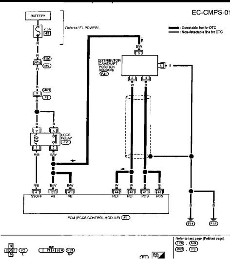

I figured out what the pin out is I posted this on KA-t.org
I finally figured out what each of the pins are for!!!!
In the manual it says that the power transistor and coil are internal (part of the reason why I was so confused). Well here is the pin out
(6x1 pin connection) 1-2-3-4-5-6
1.Goes to pin one on the ECU to pin 1 and the lead wire is white.
2.Goes to ground and is black
3.Goes to ECU pin 40 and 44 and I belive it is dioded to 44 with it eing positive, it is white
4.Goes to the ECU pin 41 and 45, it is black
5. goes to the ECU pin 56 and 61 with pin 5 on the dizzy dioded with pin 5 being positive, wires are black white
6.Goes to ground, wires are black
as fo the 2x1 connector 1-2
1.Goes to the resistor with a light green/black wire and from the resistor to the ECU using a yellow/red wire to pin 2
2. Goes from ignition somewhere using a black/red wireand is dioded
So the on the 6 pin the first 2 pins are for the transistor (pin 1 being the signal), the other 4 are for the "Cam position sensor", which I assume I can use as a CAS since it pretty much the same as the zxt dizzy.
So now I can figure out how to use MSnS with since the 280zxt version is much similar to this which I am much more familar with. Yeah less parts to buy =))

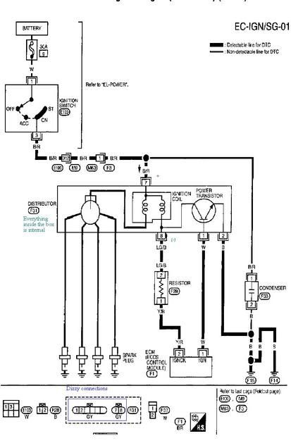

Well here's a schem of what I'm dealing with and a compareo of the setup with the zxt dizzy setup.
95 240sx dizzy/ignition out of the manual

I only have one question and its related to the ZXT dizzy setup. Looking at the diagram the CAS signal that MSnS gets is from the green/black wire, is that for the 1 degree signal or the (remember this is reffering to the L6 engine) 6 hole decoder.
In the 240sx manual its called the 180 degree signal (4 cylindar, but shouldn't it be called a 90 degree signal instead? oh well) and the 1 degree signal.
Oh another quick question. the transistor, I assume is for ballast so would I just leave the 2 leads to it just disconnected and run the coil with a straight 12v?
Source MSnS with the 4 slot trigger, the green black wire from the 280zxt dizzy is from the 6 slot wheel, not the umpteen slot wheel :). So you want to use the wire from the 4 slot wheel output on the KA24 dizzy. It was easy to tell if you got the wrong one because your cranking rpm in megatune will be crazy high if you have the 1 degree output.

If you look at the first schematic, you can see the transistor. its an internal component in the dizzy. So if I use a GM HEI modual, then I wouldn't use it, correct?
I'm sure I can figure a way to use it but I'm already confused enough and am going off of the zxt instructions to try to figure everything out.
Ok. Then how would I wire it up with the transistor? Do I even need a GM HEI modual then? From what I can figure out, this is the way to set it up with out the transistor.
Look at the first diagram to see out its wired
So the pin out is:
1. lead to the transistor, I am guessing that its the signal lead
2. lead to the transistor and goes to ground
3. 1*signal, not used
4. 180* signal,
5. 12v source
6. ground
Coil:
7. 12v to coil
8. Negative to coil
Coil is internally connected to rotor.

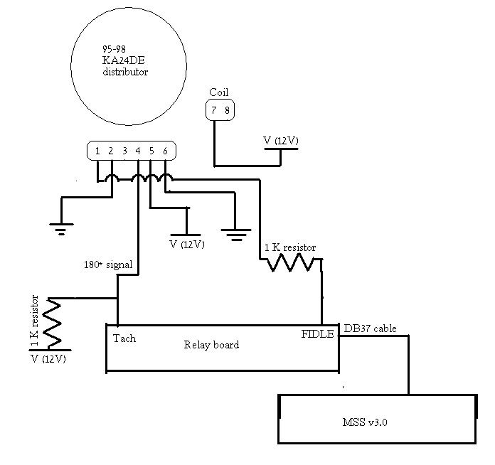

Well from what you said, this is how I thikn it would be wired. is this right? And on the v3.0 wire up, in the blue, is that right ? Shouldn't the resistor be wired in with the 180* to the relay board and not connected to 12v with a 1 k resistor?
v2.2
v3.0
I still think you want the 1K resistor to pullup on the FIDLE to the base of the transistor like it does to the "G" connection of the GM hei module(not inline lik you show it).
Yes, if pin 4 (180 degree) is the 4 slot output then everything else looks correct. I personally like to buy the megasquirt v2.2 from Jerry at DIYautotune unassembled for $134. That price rocks :)
