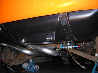

Wondering Nomad Posted May 5, 2006 Share Posted May 5, 2006 Since I do not have the tools, shop, or skills to create my own, does anybody know where I might find a sump that I can attach to my stock tank? I'd like something with two -AN6 or -AN8 outlets. The sumps for sale from Summit are too large.Any ideas? Quote Link to comment Share on other sites More sharing options...
getZ Posted May 6, 2006 Share Posted May 6, 2006 Making a sump is only half the battle. You still need to attach it. If you can't fabricate one, you can pay somebody to do it. Another option is to either run a cell or use a tank from another car. Do a search on fuel cell or sump. I personally made my own sump copying sombody elses design. It's really simple, a flat sheet of 16 guage metal with a few cuts made into it, folded into a partial box then welded together, then shaped to sit flat against the tank. Mocking it up in cardboard make a pretty good model before you cut up the sheet metal. Being able to weld and cut metal is almost a prerequisite to a successful hybrid unless you want to pay a premium for sombody else to do it or have very good friends who can do it. Quote Link to comment Share on other sites More sharing options...
Wondering Nomad Posted May 6, 2006 Author Share Posted May 6, 2006 My plan is to cut 5 1 1/2" holes in an "X" pattern in the bottom of my stock tank. I'll then weld an 8"x8" sump that is 1" deep at the port end and tapers to 1/4" at the front end. I figure this should work for my needs. But I need to find the sump...there's the problem. Quote Link to comment Share on other sites More sharing options...
getZ Posted May 9, 2006 Share Posted May 9, 2006 Making a sump is really simple. It basicly a box or even less that that cut from sheet metal. Mine's has only three folds from a sixteen guage sheet of metal with two bungs welded into the back although I run the pickup from the stock location. Quote Link to comment Share on other sites More sharing options...
