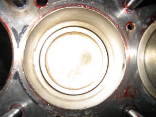

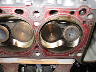

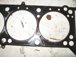

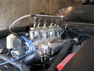

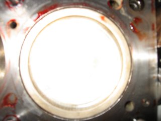

drzed Posted August 15, 2006 Author Share Posted August 15, 2006 Pics as promised. Gasket looks good - hard outline all around cylinders. Block and head also show a definate sealing line although its not as easy to see in the pics. Also included is the rednexx fuel injector test bench (or new fangled still?). Quote Link to comment Share on other sites More sharing options...
510six Posted August 16, 2006 Share Posted August 16, 2006 I would check the head with a good staight edge and a set of feeler gauges anything over .002 should be resurfaced.The stop leak I use is this, it looks like coffee grounds. http://www.barsproducts.com/product.cfm?id=38 Quote Link to comment Share on other sites More sharing options...
