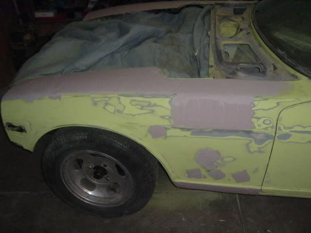

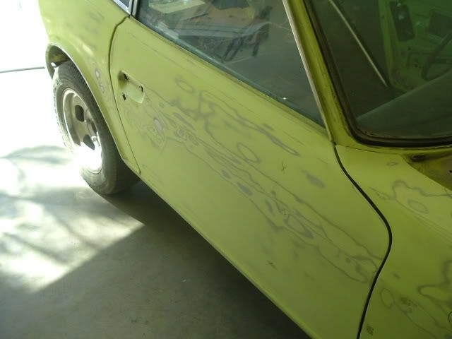

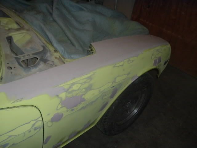

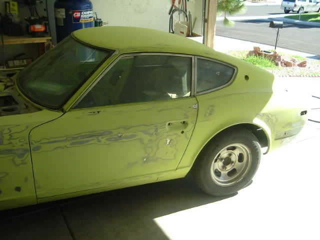

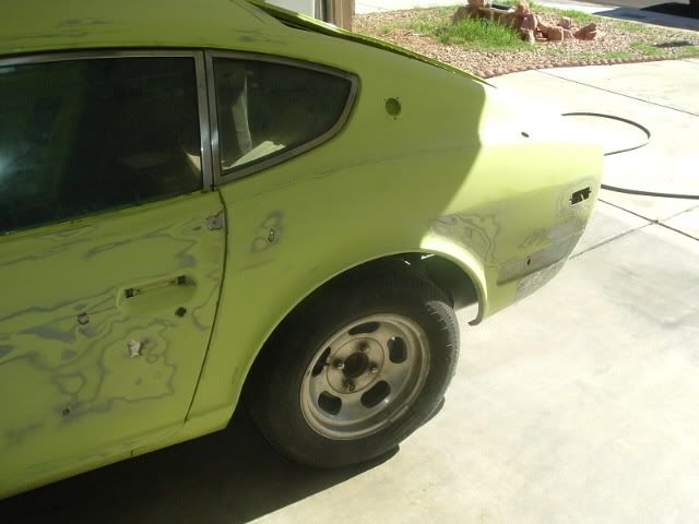

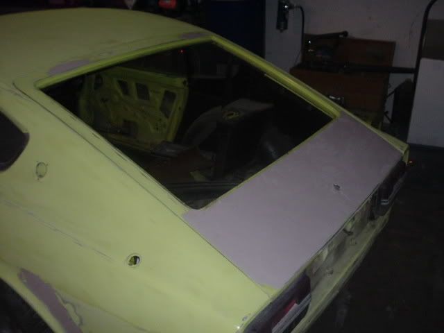

Got the car all da sanded down, bondo is on it but it got late. I'll be doing alot more sanding tomorrow. Then the polyester primer goes on some time next week. After that a ton of block sanding and she will be ready for paint. I know there looks like a ton of filler on the car, but 90% of it will be sanded off. The car is pretty straight, just lots of dings and wavy fender tops. More pics will follow after i sand off all the filler.
