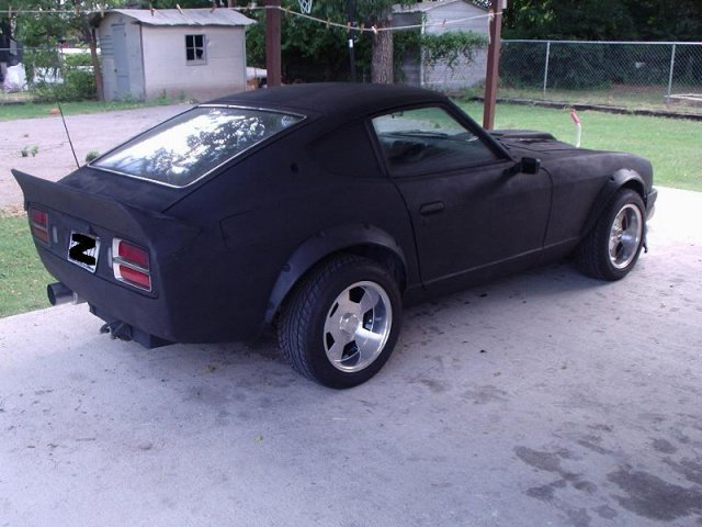

jeremy7688 Posted October 22, 2006 Share Posted October 22, 2006 I need some advise on wheel/tire combo for my 76 280z.I just bought the 84 300zx non-turbo rotors and the 1989 Toyota 4x4 calipers. I also got a set of spacers to put between the hub and the rotor. Well now my wheel hits the front side of the caliper where it meets at the hub. What size wheel and offset should I use for my set up? The hub is still the 4-lug pattern. Here is a picture of my old set set up. Quote Link to comment Share on other sites More sharing options...

jeremy7688 Posted October 23, 2006 Author Share Posted October 23, 2006 I had to grind about 1/8 off just to make the calaiper bolt to the spindle.my problem is the inside of my wheel hits the front part of the caliper.I guess it off to shop for new wheel/tire combo. Quote Link to comment Share on other sites More sharing options...

jeremy7688 Posted October 23, 2006 Author Share Posted October 23, 2006 I just tried my old wheels and they too hit the front side of the caliper. Can you grind the front side smooth on the caliper? The 89 4x4 caliper has fins or ripples that's what the wheel is hiting.what is the best size wheel and back spacing to use with this type of set up?I also have the zg flares on the car. Quote Link to comment Share on other sites More sharing options...
