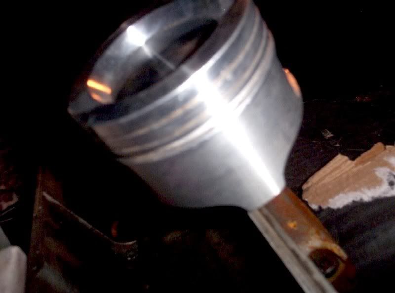

Now the other good stuff I have is custom ross pistons, new bearings, new valves for the head, and some other misc new parts to rebuild the engine to better than new status. I hope to at least get 300hp out of this car minimum. Now picture this. A 240Z in stock form is 2400lbs. I guess with the L28 and turbo goods maybe 2600lbs tops. So I figure that with that there is 1hp for every 8lbs. Now this is if I only hit 300rwhp.

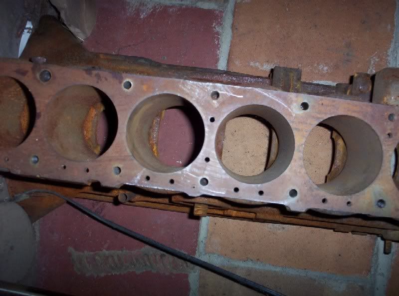

My block. Needs to be dipped badly. Honed too or maybe bored depending on how bad it is and if the pistons are for an overbored block.

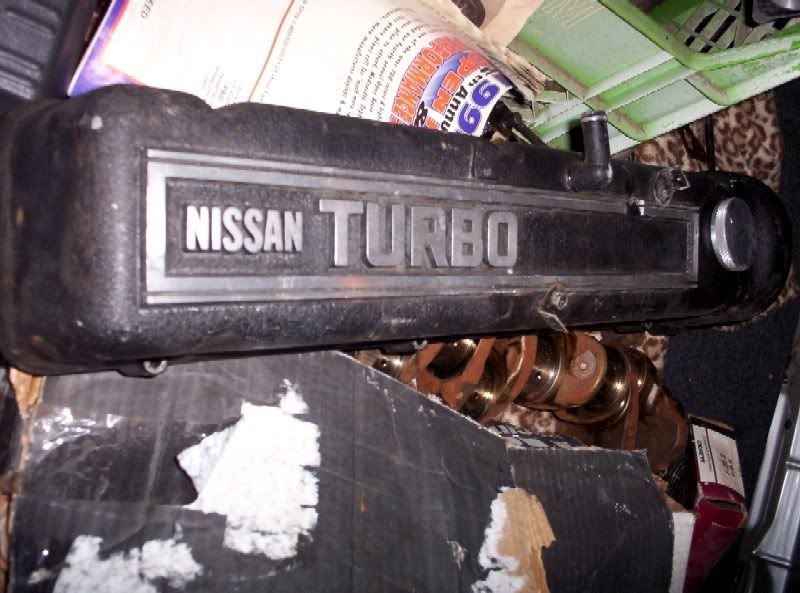

This is the 1st 6-7 boxes of stuff I have. I have 3 more + the head in the trunk of my accord.

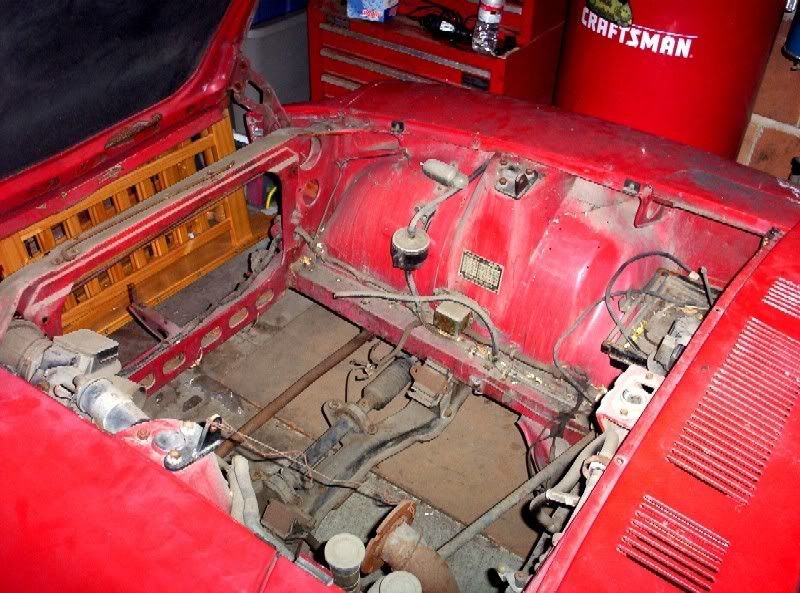

This is the worst rust I found so far. I’m told they have a replacement panel for it though and I need to find who sells it. Hooray

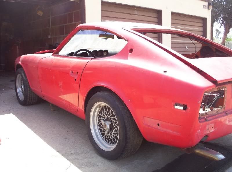

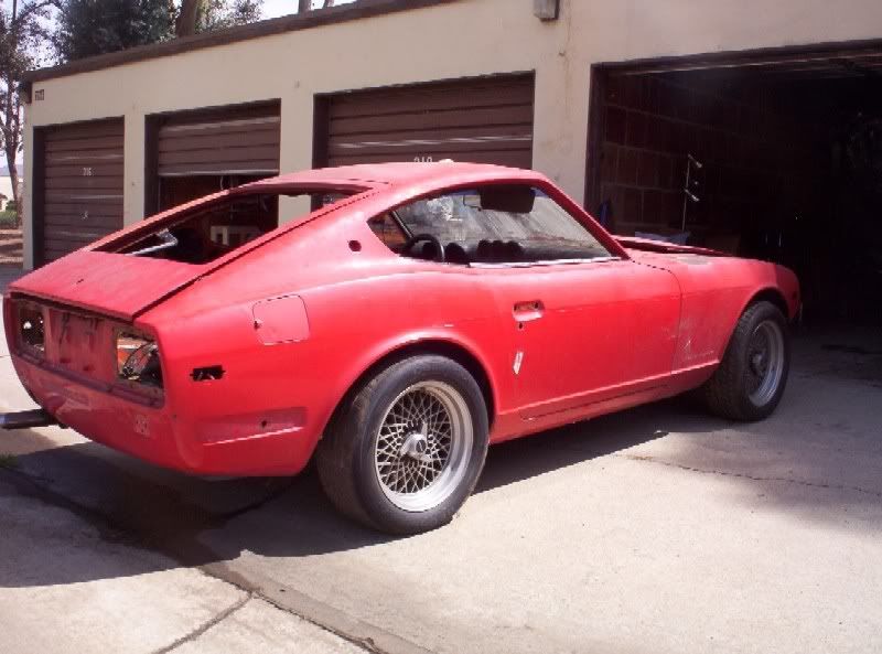

And lastly this is my other ’72 240Z I purchased today. It came with a SR20det in it. It’ll do. I want these JDM fender mirrors, ZG flares, and the RS Watanabe deep dish 16’s that this car has. Once my big car gets painted this one will be painted to match.

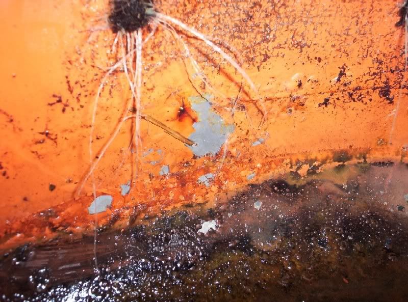

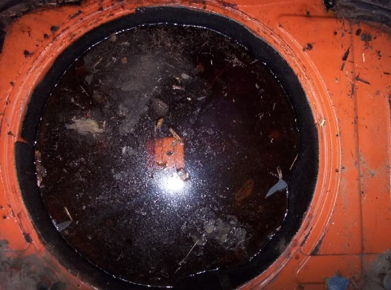

Once again I really hate uncaring previous owners. Especially one’s who are so called “Z enthusiasts.” Does a “Z enthusiast” leave a Z taken apart outside and not even under a tarp for 10+ years. Does a “Z Enthusiast” do that? I’ve had my personal cars parked outside 99% of the time, but they are put together. They have side windows. They have the molding around the windshield and hatch window. They have the door locks attached. They do not have a god damn trout farm in the trunk of the car. Can you tell I’m a little perturbed? So onto the pictures.
If anyone remembers the clown fish in the car from the 1st set of pictures I think it was trying to jump out of this. When you make a fish attempt suicide you know it’s bad.
My 1st scoop of this wonderful nectar. Anyone think if I drink it I’ll get a buzz?
Obviously the paint is lifting. But surprisingly the rust is minimal. No rust has eaten through the metal entirely hence my personal lagoon. So far this is mainly surface rust, but some is a little deep. I’m going to try to get it all out and paint it with engine paint then apply some liquid sound deadening.

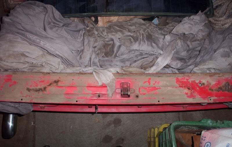

And lastly here’s all the ♥♥♥♥ I’ve taken out and thrown away from the rear of the car. Note to Z owners. Please do not screw a false floor directly to the metal. Everyone will hate you.

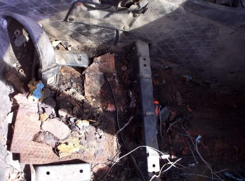

So I moved on to something else I could do with out power tools. I started pulling the carpet and other misc trash from the passengerside floorboard. I really wish this guy would've at least still had the side windows installed. Oh and why is the carpet held down by screws drilled directly into the metal. WTF?!?!?!?!?!?!? So I pull up the carpet and padding underneath and I found a bunch of surface rust and so far only 1 spot where it rust through and that might have been from me jabbing to get some of the factory deadening off. So I need to get the heat gun and my shop vac and get all that stuff off too to see how bad it is underneath it all to see if I can just do a patch or if I need to replace the full floor which I really don't want to do.

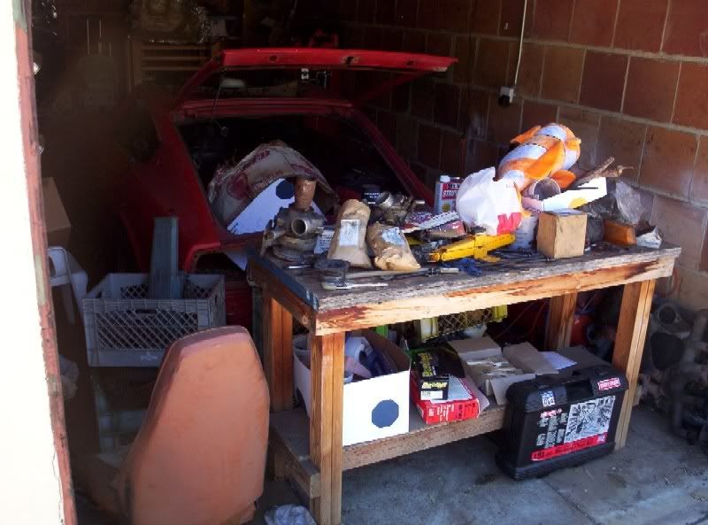

Well I just go back from vacation and now it’s back to the grind. I haven’t really done anything, but try to reorganize my garage. I ended up with much more space, but after further thought afterwards I need to actually relocate my work bench and all parts to in front of the car. That way I don’t have to move so much stuff around when I work in the car.

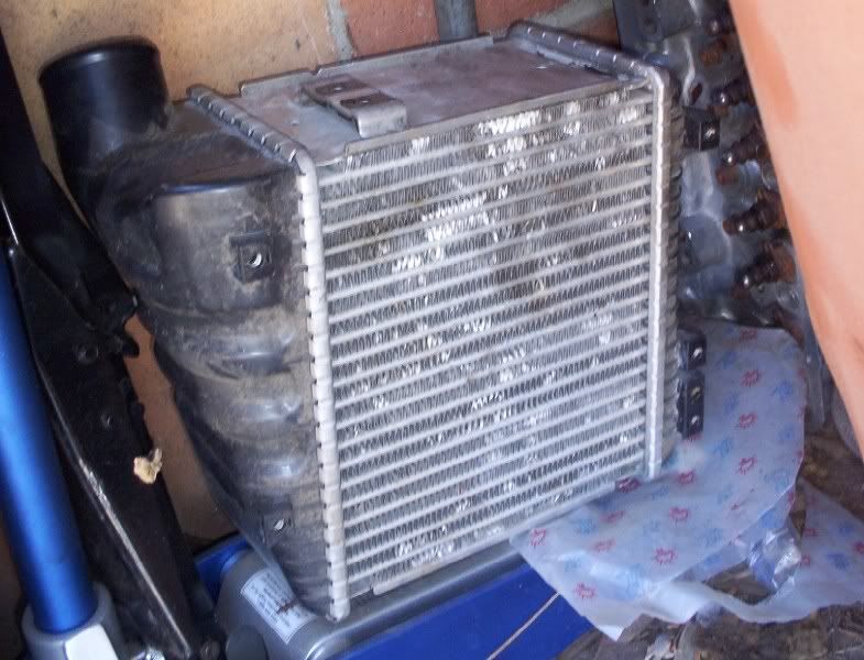

Here’s my Supra TT i/c that I am 80% likely to not use.

Here’s what I’m working on with the passenger floor board. I need to vacuum it real bad. It looks worse than it is because of all the trash and dirt. I did get my heat gun back from my dad so I can strip off the factory sound deadening.

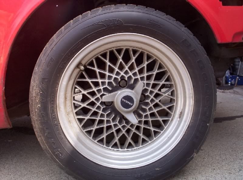

Pic of my Crager wheels.

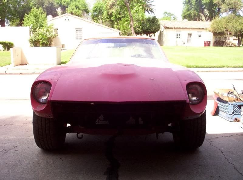

Oh and fine. Here’s pics of my damn car. Babies. :D

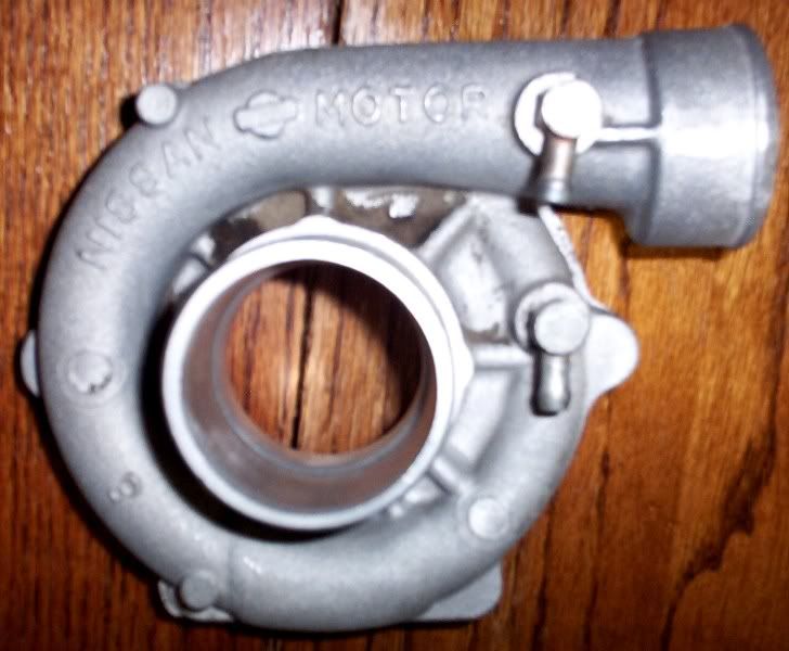

I'm starting to rebuild a stock 280zx turbo I got off of someone from another forum. I've only got the turbine housing off so far and did 1 long dip in carb cleaner. Got 98% of the dirt off and the other 2% will take some work with a piece of a rag and a toothpick. I should've taken a before pic cause this thing has 300k miles on it.
