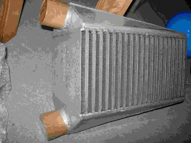

datman Posted March 22, 2007 Share Posted March 22, 2007 I recently bought this AiReasearch intercooler. It has a vertical core. 13" long 7" deep by 7" high. Part numbers AiResearch 469760-1 charge air cooler. industrial division does anyone know anything about this type of cooler. I've been told it was used on Zakspeed capri's in the 80's Quote Link to comment Share on other sites More sharing options...
thehelix112 Posted March 22, 2007 Share Posted March 22, 2007 7" deep? Jesus. I believe AiResearch is what Garrett was called originally, stand to be corrected on that one though. Garrett cores, like their turbochargers, are pretty decent. 7" deep.. holy hell batman. If i were you and was going to install that, I would be thinking VERY carefully about my entry and exit shrouding. But then, we all should really. Dave Quote Link to comment Share on other sites More sharing options...
datman Posted March 22, 2007 Author Share Posted March 22, 2007 Yes you're right I think AR were part of Garret...probably still are. I read somewhere that any core over 3.5" is too thick because the air stalls going through the core....on the other hand surely AR knew what they were doing when they did "research" Quote Link to comment Share on other sites More sharing options...
thehelix112 Posted March 22, 2007 Share Posted March 22, 2007 I think it all depends on application. On a street car with no ducting, the air may well just spill around the sides instead of flowing nicely through. On a race car with a properly placed ducting entry (high pressure zone) and exit (low pressure zone) the air is PULLED through the core which allows you to run something thicker. How much did you pay for that core? I am envious. Quote Link to comment Share on other sites More sharing options...
