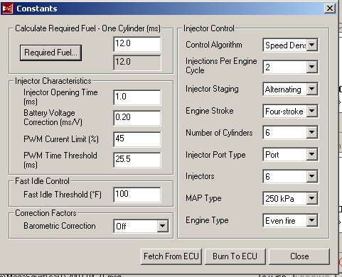

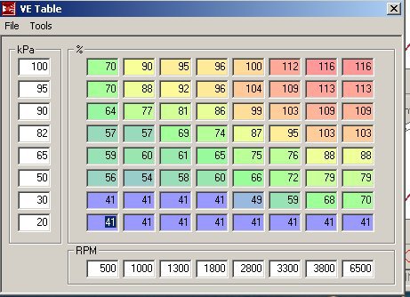

OK, I got my NA L28 with a 60mm TB and stock injectors (no resistors) running on MS 1:icon10: - but she runs like crap!:icon_frowLots of lean backfires out the TB off the line. On cruising the O2 sensor is modulating between way rich and way lean...what could cause that? On deccel I am getting a way rich condition. I am posting some screen captures...any help or suggestions would be appriciated.

OK, reading some other posts I am confused about the ego read out....when the dots on the Megatune screen are green is this rich or lean???? I was assuming that the green dots meant lean since the car was backfiring through the intake and that into the red dots meant rich...do I have this backwards?
Thanks,
Joe
