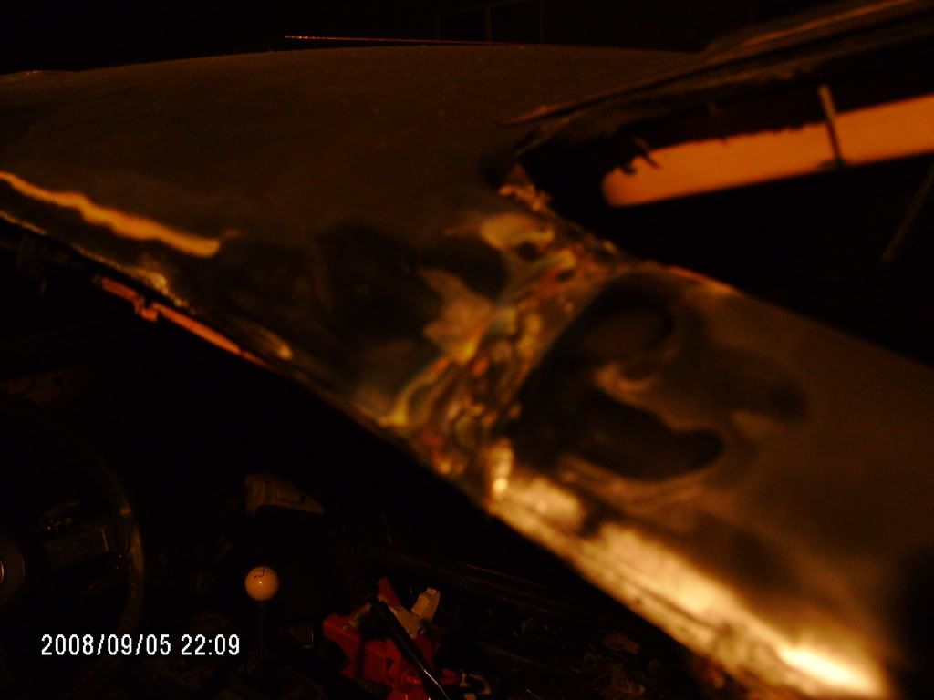

Picked up a MSA Type 3 front air dam last night. I also worked on plating the rocker where I will be attaching the floor section of the cage. It looks horrible right now, but I think I have my method figured out. The passenger side will go much faster now. I just need to make sure I don't deform the structure of the car while modifying the rockers. The floor is completely gone on the drivers side and half gone on the passenger side.
The rockers are filled with tar so I have to burn that out before I can weld the new rocker plates in. Slow going, but its going. I'll mount the type 3 bumper this weekend, along with welding in rocker mounting plates. I need a level to get everything square. Pictures coming soon once I patch up this rocker. Its UGLY right now and I'm a bit embarrassed to have cut so much away :)
