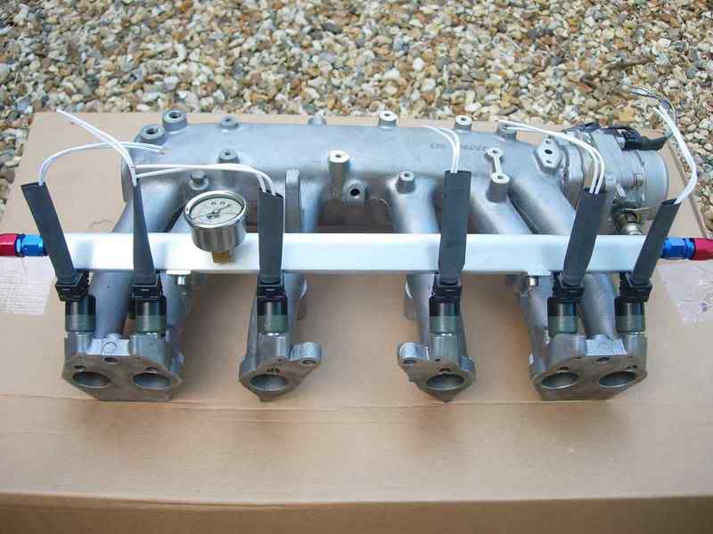

Hey guys just though I'd post a couple of pics of my intake manifold to see what you think.
I have an n42 intake manifold modified to take delphi 650cc injectors, I also ended up modifying the Pallnet fuel rail as I bought the 11mm version but needed 14mm, look prety nice.?action=view&current=intake1.jpg

By the way, your intake looks VERY nice. Good work.
Thanks BRAAP, I have some waterproof multi pin conectors on order, I am going to make a loom so I can unplug the manifold wiring in one go.
I'd like to make the throttle work by cable instead of linkages, will have to try and fab something up to go on the throttle body.
