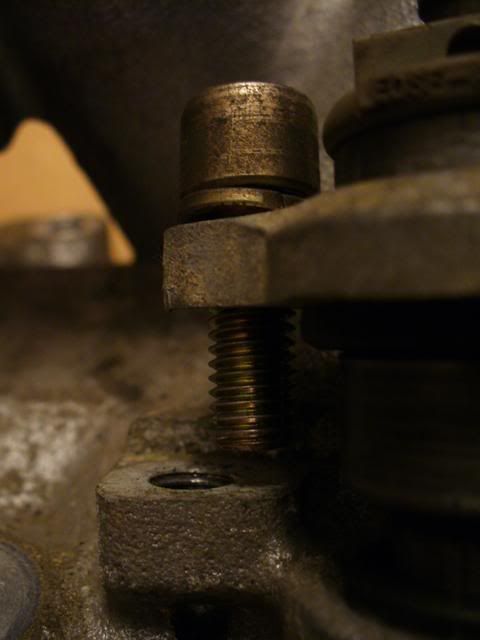

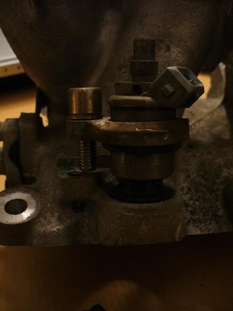

hoohaa Posted June 28, 2007 Share Posted June 28, 2007 So I want to run Ford CFI 440cc injectors in my VG30. I have a pathfinder lower intake manifold on the bench along with a Z31 top feed fuel rail and regulator. It only takes a single glance to realize that the Z31 rail and hold-downs are not going to work on the pathy lower IM. The outside bolt holes don't line up and there isn't a bolt hole at all on the center injector. I could weld up some little platforms that I could tap out to be able to use the Z31 hold downs, or I could machine a brand new set of rails, or perhaps there's another lower IM that would be compatible with the Pathy upper IM and receive those Z31 hold-down bolts? I would greatly prefer the latter option, although if it comes down to it I will definitely weld up some hold-down platforms. Here are a few pics of the non-fitment: Quote Link to comment Share on other sites More sharing options...
hoohaa Posted June 29, 2007 Author Share Posted June 29, 2007 I believe the best option will be to use a z31 lower manifold. I just confirmed that this is possible. The pathy manifold FAQ on z31.com was down when I tried to check. Quote Link to comment Share on other sites More sharing options...
mtcookson Posted June 29, 2007 Share Posted June 29, 2007 Yup, use an early Z31 lower manifold or you might also be able to use a 85-88 Maxima lower or 90-92 Infiniti M30 lower. I believe those are all top feed. The early Z will likely be the most common and easiest to get. Quote Link to comment Share on other sites More sharing options...
1FASTKINGCAB Posted June 29, 2007 Share Posted June 29, 2007 I believe the best option will be to use a z31 lower manifold. I just confirmed that this is possible. The pathy manifold FAQ on z31.com was down when I tried to check. X3 the lowers ate the same form Z21- D21 just all the Z31's and early trucks (90-92) use top feed injectors. Nissan chaned all the VG30's over to sidefeed injectors in early 93 Quote Link to comment Share on other sites More sharing options...
