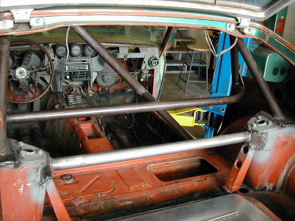

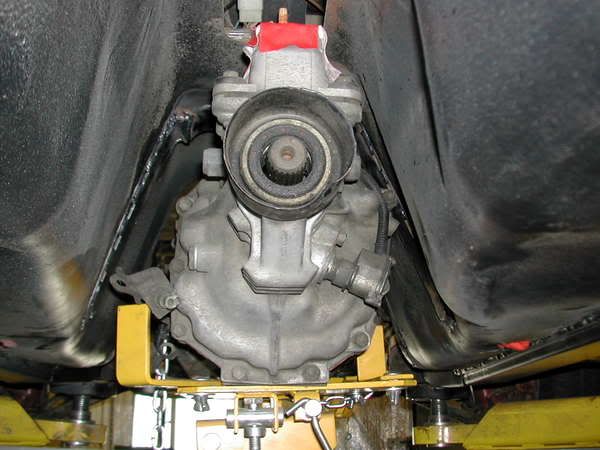

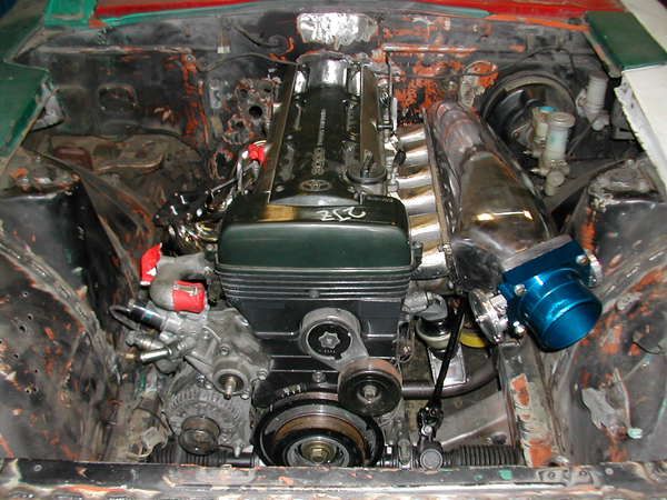

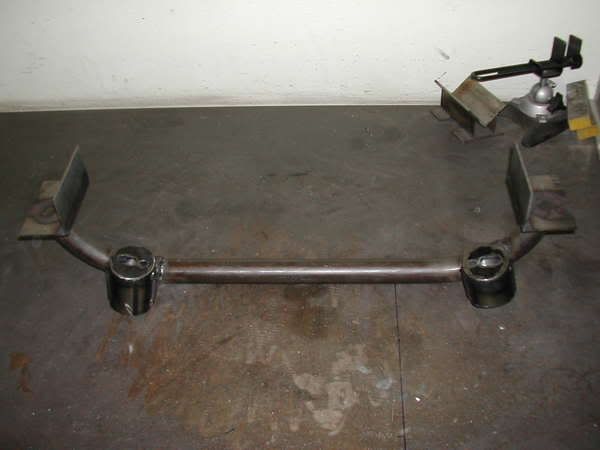

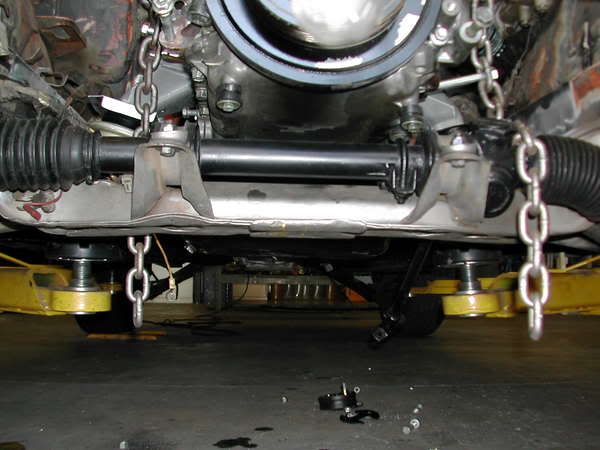

oatmilk Posted September 2, 2007 Share Posted September 2, 2007 Parts: JDM Aristo 2jzgte engine only with cut harness USDM OBD-1 ECU USDM OBD-1 engine harness USDM complete water pump USDM Mid sump middle pan/oil pan with USDM splash guard HKS V-Pro Stand alone with various HKS sensors for it Wide band o2 (either HKS Knock-amp or AEM) PHR upgraded valve springs Garrett GT4088R turbo PHR upgraded oil pump New engine gasket set 3rd gen Supra turbo 5 spd transmission, R-154 Exedy Hyper Single lightweight 1jz flywheel/clutch combo 1jz Bell hosuing Ebay divided outlet SS turbo manifold Ebay Veilside Intake manifold Ebay SS 3" down pipe GT Pro aluminum fuel rail Siemens 1600cc injectors Walbro fuel regulator ATL fuel cell brand new with built in surge tank/Bosch 044 fuel pump with E85 okay foam Earls teflon coated fuel lines, -6 and -8 Quaiffe LSD brand new Z31 axles and CV's 240z body shell with old drag style 6 point roll bar Tokico HTS struts MM Cobra front brake set and 5 lug hubs MM Billet rear 5 lug hubs (to be ordered) MM Rear arms (maybe) HKS or GMS Cams (to be ordered) AEM cam gears more stuff to come and probably missing a few parts I have somewhere Pics to come. Quote Link to comment Share on other sites More sharing options...
oatmilk Posted September 3, 2007 Author Share Posted September 3, 2007 Quote Link to comment Share on other sites More sharing options...
oatmilk Posted September 30, 2007 Author Share Posted September 30, 2007 Quote Link to comment Share on other sites More sharing options...

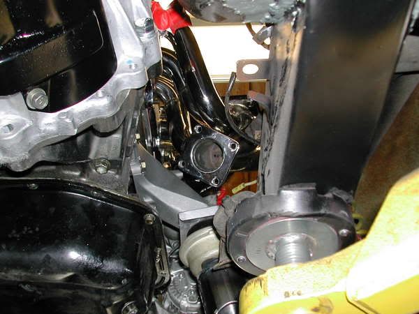

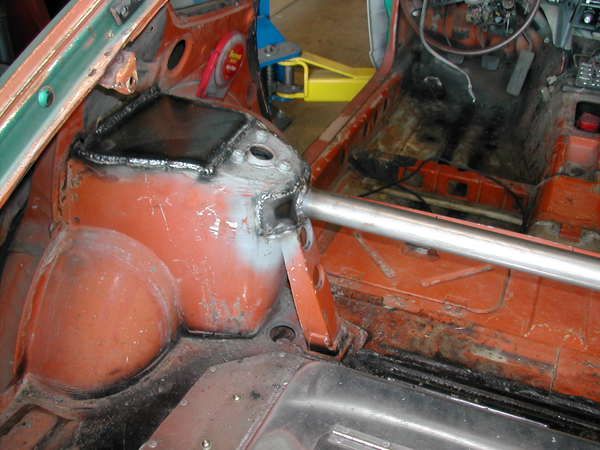

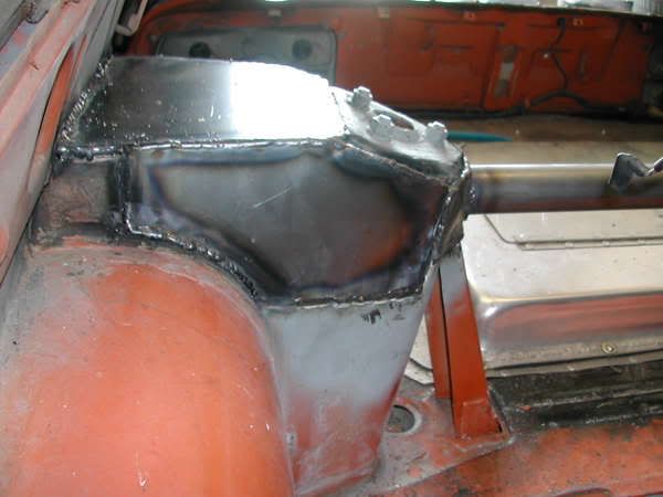

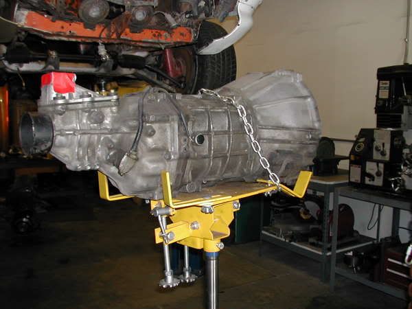

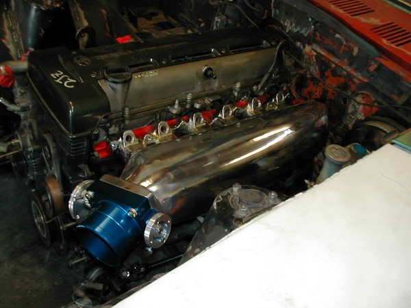

oatmilk Posted October 12, 2007 Author Share Posted October 12, 2007 Next up suspension after this. Quote Link to comment Share on other sites More sharing options...

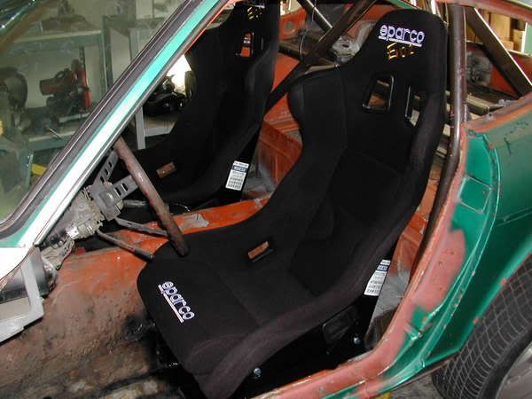

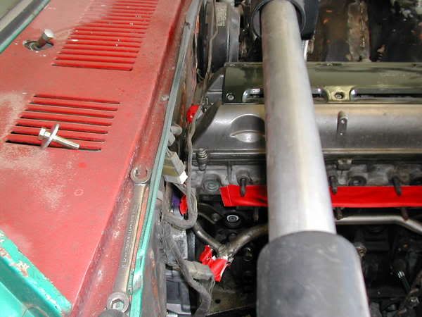

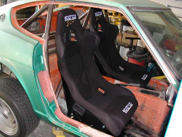

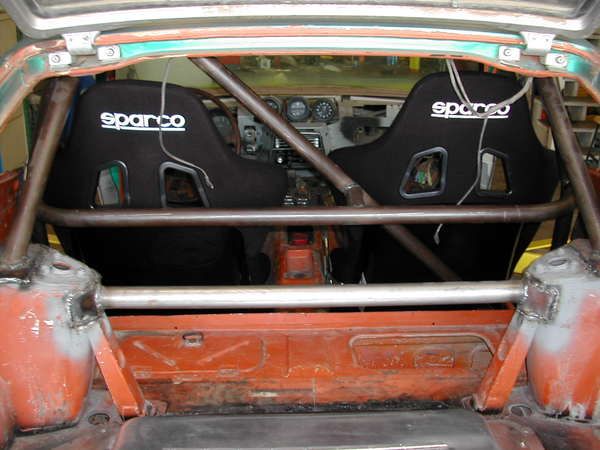

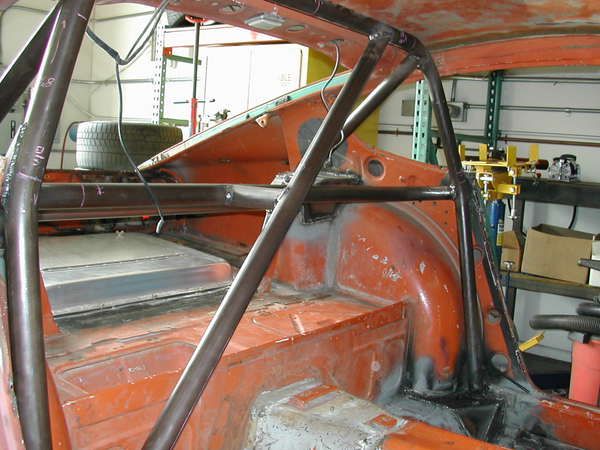

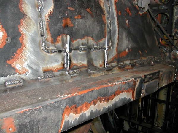

oatmilk Posted December 19, 2007 Author Share Posted December 19, 2007 Decided that since it will be a street/track car and I didn't want my passengers always having to wear a helmet on the street, no full cage for now. More pics to come. Quote Link to comment Share on other sites More sharing options...
oatmilk Posted January 9, 2008 Author Share Posted January 9, 2008 next up the brakes, suspension and rear flares. Quote Link to comment Share on other sites More sharing options...
