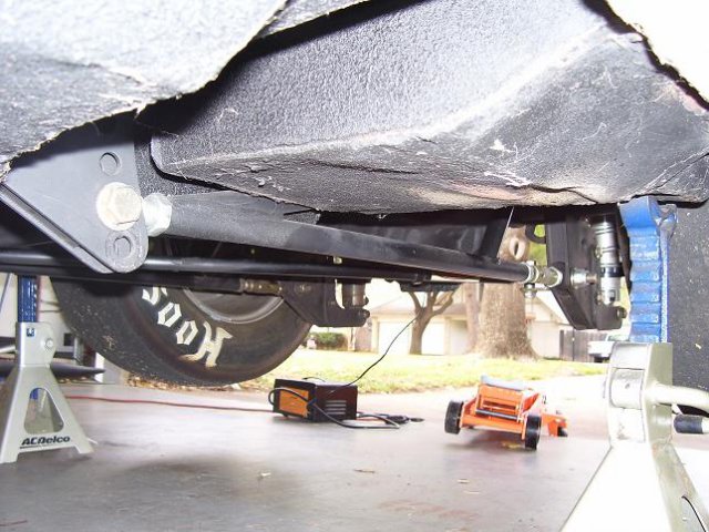

sick240 Posted December 8, 2007 Share Posted December 8, 2007 this was taken today right before i dropped the bars down to the last hole, trying to keep the front down some on take off:wink: my next choice will be travel limiters. Quote Link to comment Share on other sites More sharing options...

sick240 Posted December 9, 2007 Share Posted December 9, 2007 justin, this was the first ladder bar set up i have done, and if i was to do it again i would not bring the tunles up as far as i did. the reason behind this is i had 5 adjustments and i made sure i had plenty of room for each one. now after having the car on the track/street i would never use the top 3 unless i wanted to enter a wheelie contest. so if i was to do it again you could easily do it without even having to come up as high as i did, more like Roller's car. Quote Link to comment Share on other sites More sharing options...
