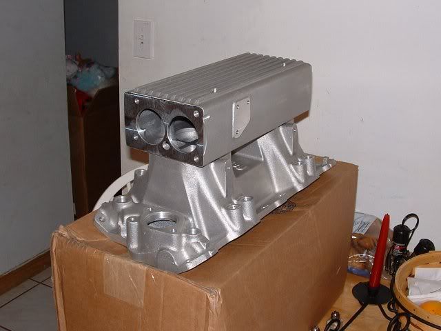

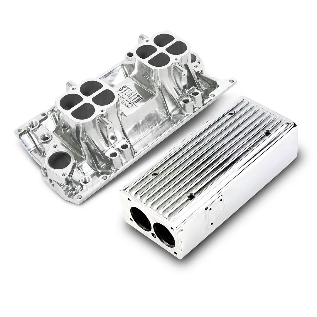

Administrators BRAAP Posted December 16, 2007 Author Administrators Share Posted December 16, 2007 As far as I know, this manifold has been in production for quite a while. It is basically a recasting of the street tunnel ram with 8 injector bosses cast in the bottom of the base and a plenum box similar the TPI plenum that bolts on to the top. Recently the base has been cast/machined for the GM Vortec intake ports and bolt pattern. Quote Link to comment Share on other sites More sharing options...

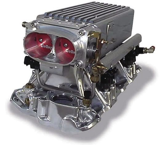

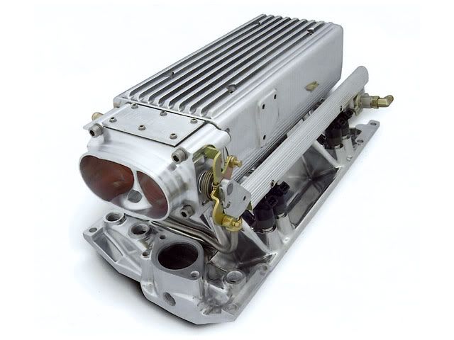

getZ Posted December 17, 2007 Share Posted December 17, 2007 I was planning on using that manifold on my car as well. I saw a picture of somebody who was running one a while back and it seems to fit without a problem: http://www.gmhightechperformance.com/tech/0307htp_hollley_stealthram_intake_third_gen_iroc/index.html http://stealthram.com/ I still haven't decided which route to go yet with either a stock 88 computer or an after market ecu. If you have an older style tpi (I think it was 89 and earlier) there is no provision for a ninth injector so you need a chip burned for cold startups. Quote Link to comment Share on other sites More sharing options...
strotter Posted December 18, 2007 Share Posted December 18, 2007 I have one on my '72, and somebody else here has one on an S30 as well. Yes, they fit fine. I'm running a .7730 ecu, such as out of an early '90's Camaro (though the actual computer came from a Beretta). Quote Link to comment Share on other sites More sharing options...
