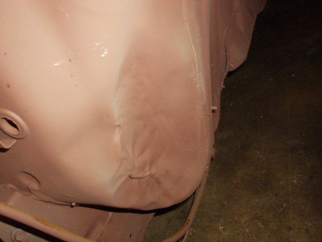

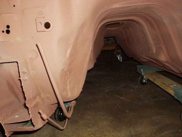

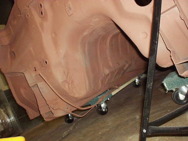

I have a th350 in my Z31. You should have enough room in the tunnel for either the 350 or the 700. That's the good news. When I put mine in I had to mod the firewall just a little to clear bell housing on the automatic. It is easy enough to dop with a four pound sledge and a little attitude. :) Here are some pictures of the firewall where I "altered" it. Like I said, it doesn't take much and will hardly show. I hope this helps. Good luck

Thanks Chaparral2f. I'm just about ready to get to work on my car now. For the short time I've been here and I've already gotten a lot of help here. It's great here, I can't wait to post up my build thread. Thank You All.
