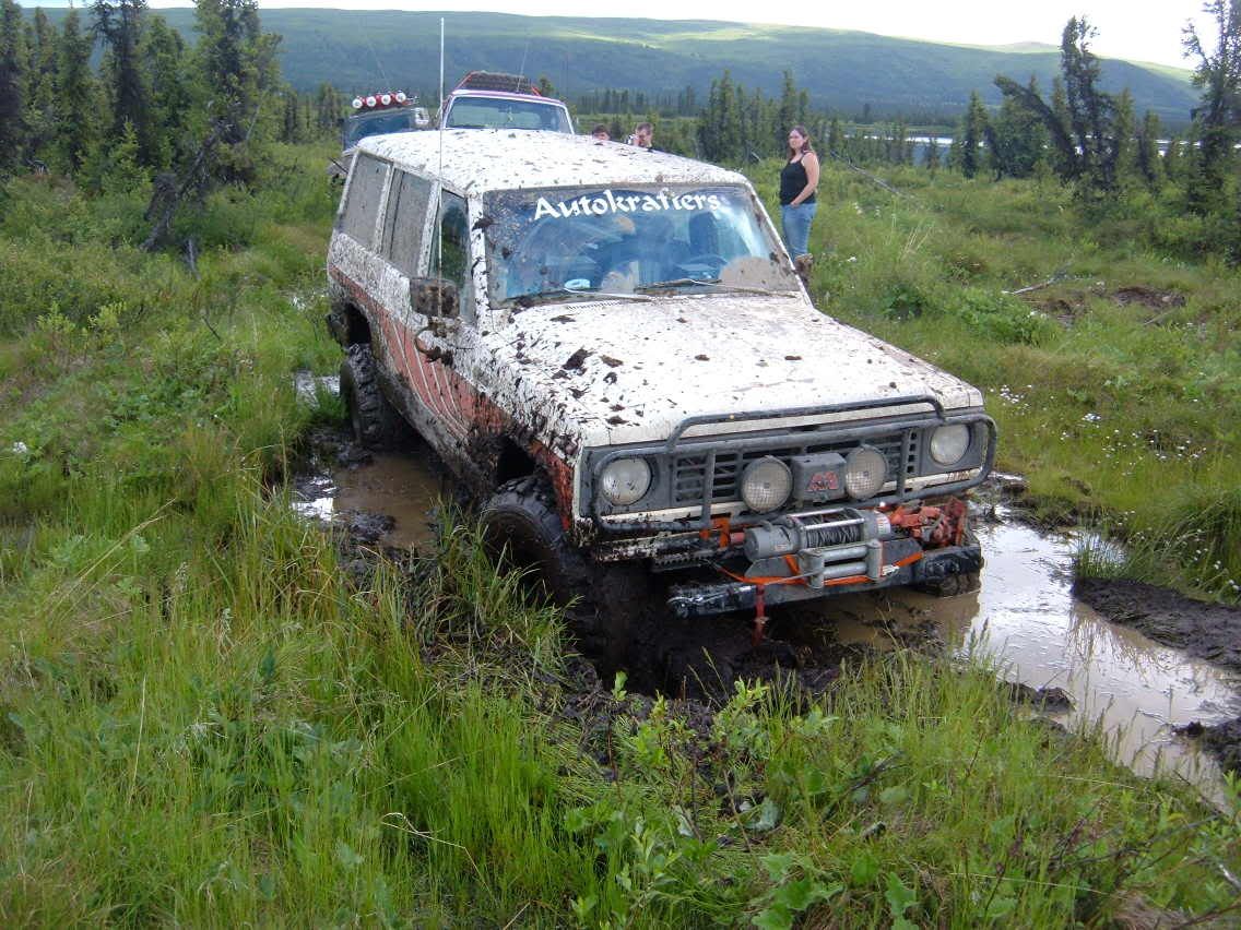

Not sure where to put this but since it deals with 6 cyl figured this is the best place for it.i have a 1981 nissan patrol mq lwb,it has the 2.8l 6 cyl in it-same basic engine as the 280z.it is real low on power and has no torque,factory new rating is only 120 hp and this engine is tired.prtobly only has 80 hp left in it lol.this is one of less than 50 of the mq series in the us and i want to keep it all nissan because of it.

heres a pic of it
