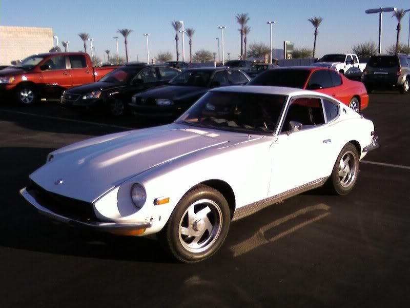

Most of you know I got this 11/72 240Z for a steal from a guy who had no idea what he had. When I first saw the car it was busted up, would barely run , and in tons of pieces. I towed it to a nearby relatives house the next day. I threw brake pads on the front and charged the battery. A little gas and it fired up. NONE of the electrical worked not even the brake lights. It ran off battery power only because the Alt was not working. I then drove it 40 miles to the dealership where I work.
The car as I got it:

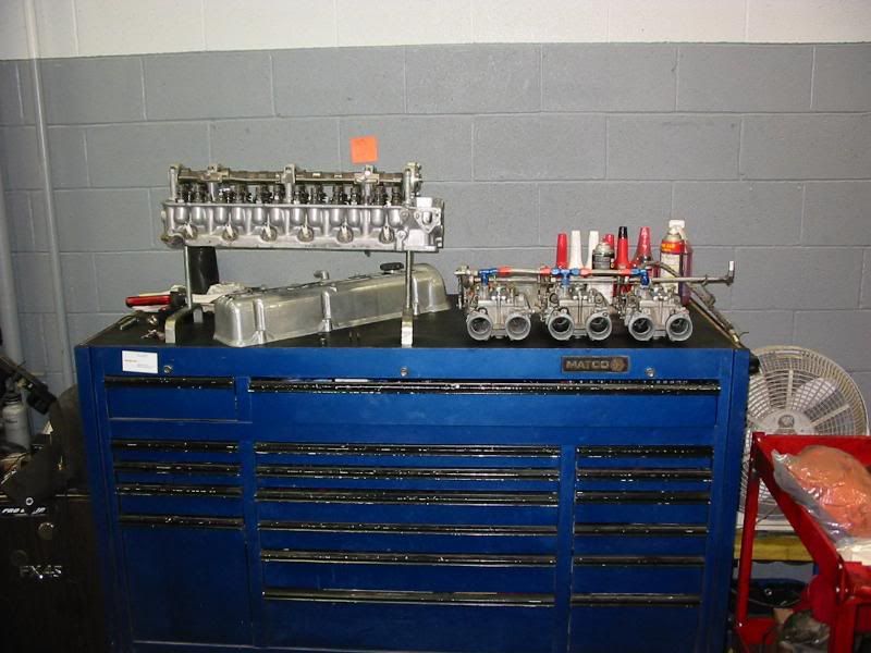

L28 flat top block
E31 L24 head

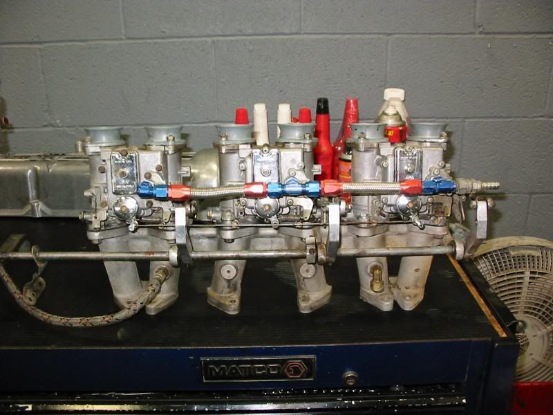

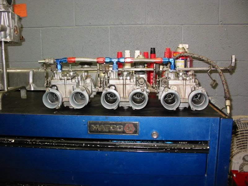

Triple Mikuni 44's
4 Speed
Aftermarket rear sway bar
Horrible wiring

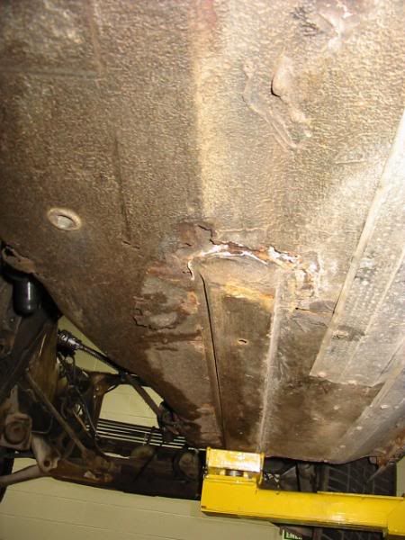

Not a lot of rust surprisingly
And the rest was old and stock.

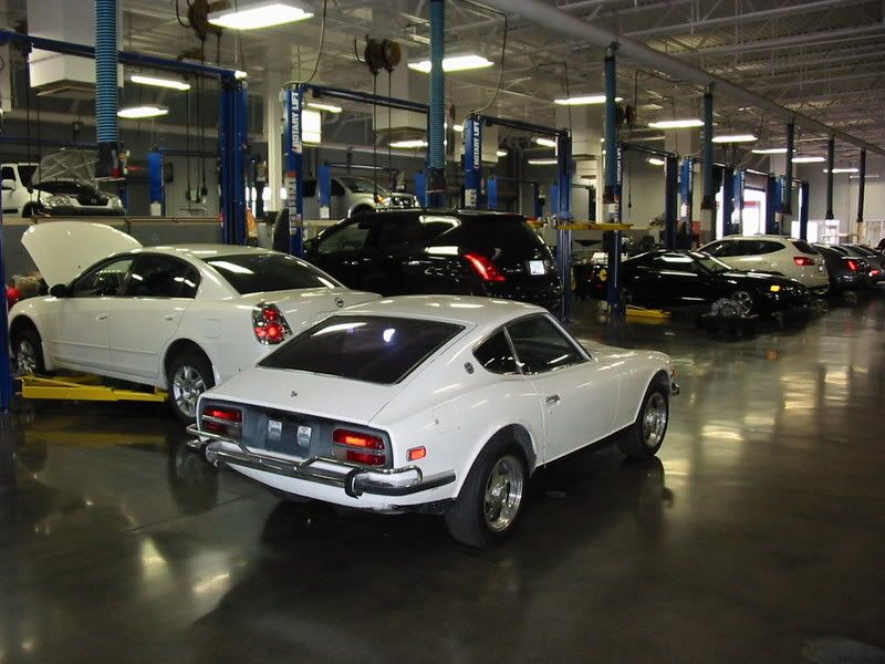

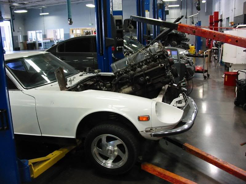

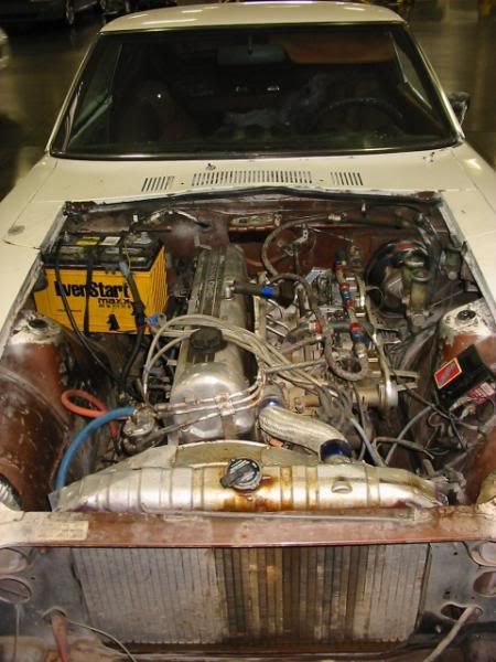

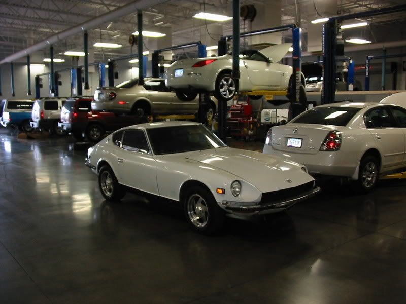

When I brought it to the dealership (its current home)
Videos of the first day after juspstarting it
A couple in the shop

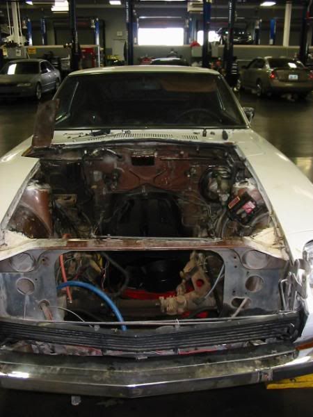

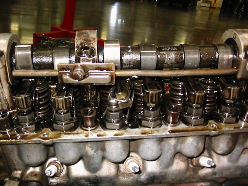

Starting the teardown

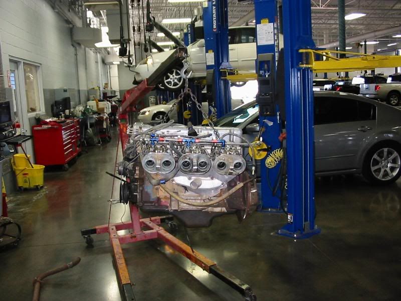

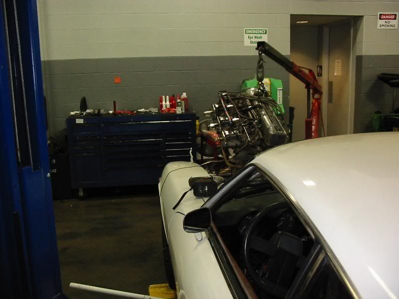

Motor out man I wish it was this easy on all Nissans

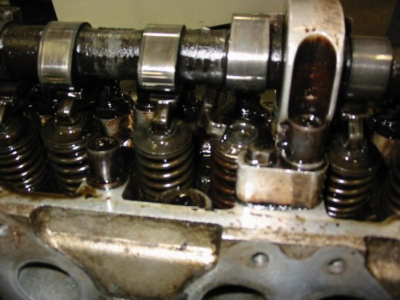

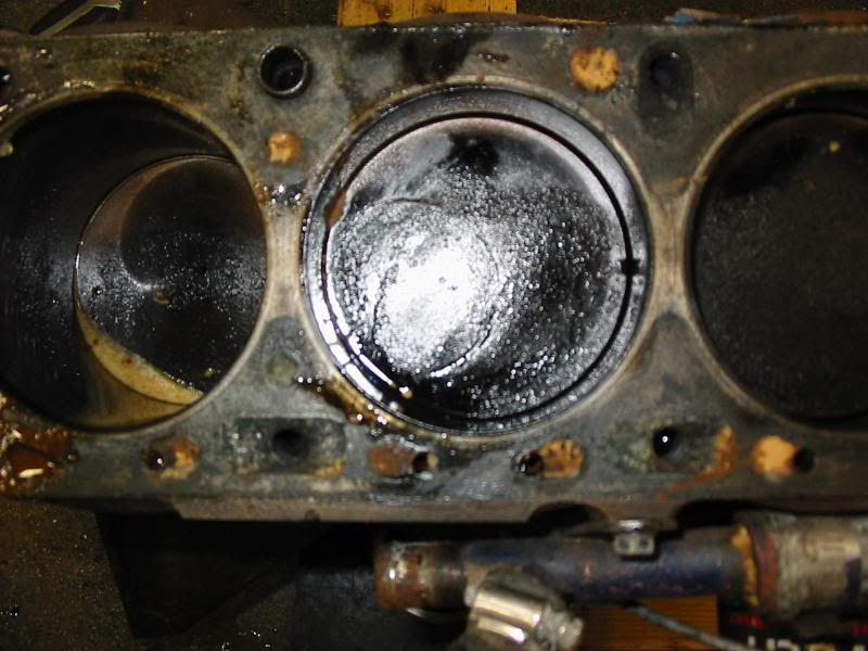

WOOPS notice anything
I love this machine

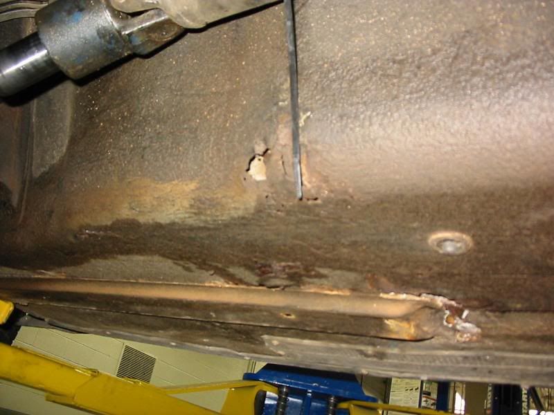

This is the rust (besides the doglegs)

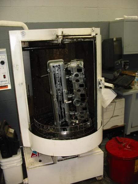

ENGINE

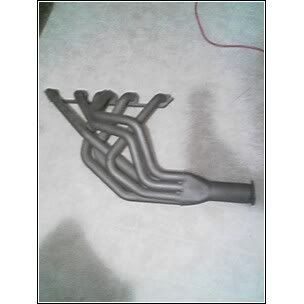

Larger valves
Good cam
Port
Turbo head bolts
Race oil pan
Rotating assy. balance
Block refresh (rings, bearings)
LD28 main bolts
Aluminum radiator
All on the E31 head and my low mileage 83 zx flat top block
