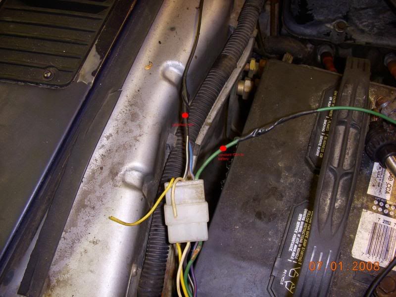

ZXT_bean Posted July 1, 2008 Share Posted July 1, 2008 ok well ive been working on this for a good 3 days now, and yes ive searched many of swap threads, and would like to make sure i have everything wired correctly. i think i have a bad ignitor, but am not 100% sure. i am about to go by one for 160 dollars, and before i go by one.. id like to double check everything with the fellow Z gods. any and all help would be greatly appreciated. i have the green light on inside the ecu, and it pulses during cranking. i can hear my injectors pulsing. i just have no spark. i even went and bought a new coil. i have rehosted these, so please click for a much larger image. i dont mind going to buy a new ignitor, but i need to know i have everything wired correctly before i install it and blow up another one. thanks again! Quote Link to comment Share on other sites More sharing options...
JSM Posted July 1, 2008 Share Posted July 1, 2008 You checked ebay for an ignitor? Your pics and labling are great. You should label all the plugs and include the wires for the fuel pump and main power to help others. I've got an extra one that I paid $10 for from the junkyard. Your more then welcome to it for 10 plus shipping. I have not verified if it works, nor can I currently w/ my 280zxt motor out of the car. Quote Link to comment Share on other sites More sharing options...
ZXT_bean Posted July 1, 2008 Author Share Posted July 1, 2008 yea ive checked ebay, i havent been able to find one with the correct part number. so dont want to risk buying the wrong part. ill get back to you on shipping the ignitor. i still need to verify all this wiring is correct. Quote Link to comment Share on other sites More sharing options...
Guest Dan Gleason Posted July 5, 2008 Share Posted July 5, 2008 Are you getting a pulse on the negative (-) side of coil when you crank the engine. If you use a test light ground the clip and touch the terminal (-) with the probe light. The light should come on while cranking the engine and appear to be pulsing Brighter as the signal comes through. If the neg side of the coil does not pulse the ECU is not sending the signal DAN Quote Link to comment Share on other sites More sharing options...
