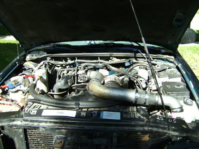

scottyMIz Posted July 22, 2008 Share Posted July 22, 2008 i know this isn't a z but it has i guess u would call it the lungs of a nissan i took my old stock garret t3 from my L28et and finally used it again here is the outside now for the good stuff made my own manifold had to mod the lower rad line out of the block so the turbo could have an air cleaner i was just seeing if my t3/t4e franken turbo would fit on it.... and it does barely tell its back there most guys put the turbos in front of the engine replacing the fan. just a quick shot of the ic piping i put the ic in the engine bay for time being i am gonna move it out in front as soon as the ic pipe kit comes in. and a quick vid oh yea running 5 psi and i blew a hose off in the vid when i blow it up im going rb20det Quote Link to comment Share on other sites More sharing options...
