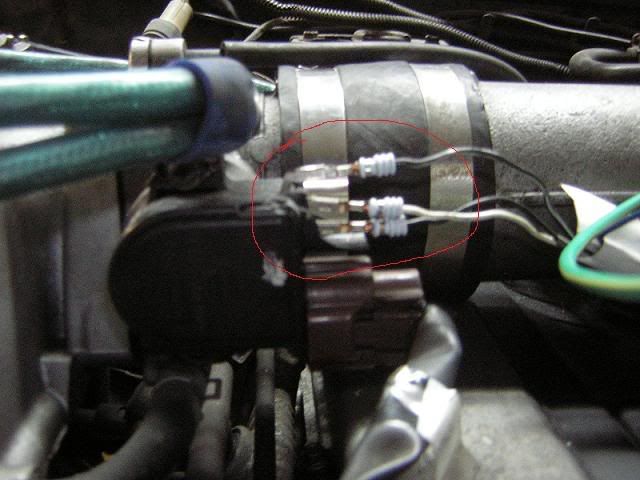

That would be great! Heres what Im missing:
Thats the MAF sensor, its located on the throttle body.

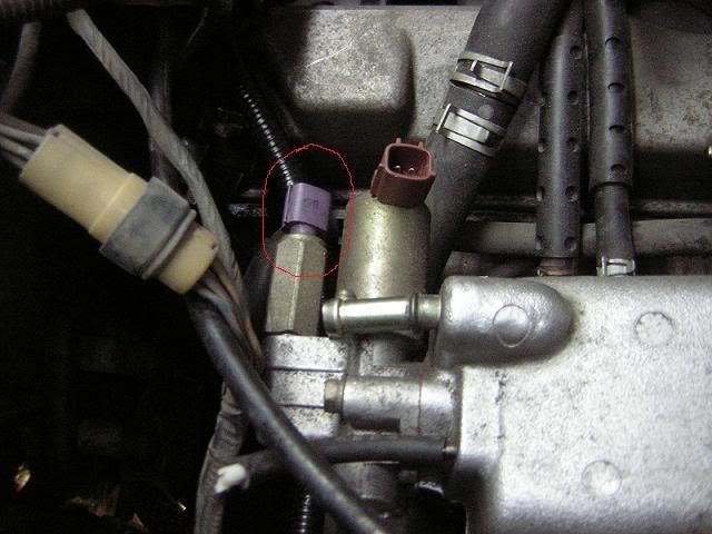

Im also missing the connector that plugs into this purple one (Im not really sure what it is haha, its located on the plenum towards the rear.

Dude, thats a TPS plug. Throttle position sensor. Not MAF.
Take your TPS to a junkyard and look at some nissans. I know that connector is on maximas and altimas (or at least VERY close). You can make them work for sure.
The other connection is for the valve that idles up the car when the A/C comes on. You don't really "need" it. Tape up the wires and keep an eye out at the junkyard for a suitable replacement.
