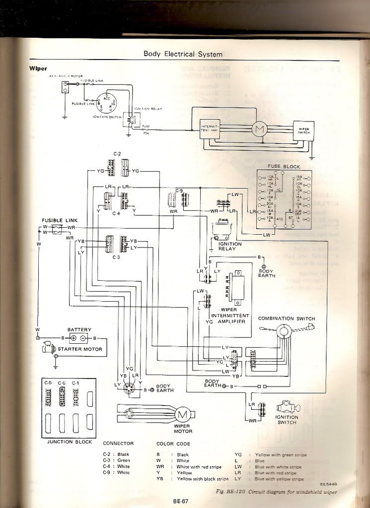

I have a "77 280Z we put a 350 in and are having trouble figuring out the wiring of the wiper motor. I have numerous diagrams but none tell me what color wire does what function for the motor, intermittent amp and so forth. I am using a Painless 18 circuit wiring harness #10202. Some of my frustrations are with the fact that the wire colors going into the 6 pin round plug (male end) from the wiper motor are different in color than the wires in the corresponding (female end) plug. Any help or direction you can supply me will be greatly appreciated.
