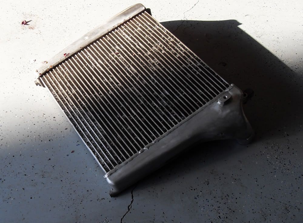

Vg30eT-240z Posted October 19, 2008 Share Posted October 19, 2008 Would this fit on my 240z if i buy it, without any modifications to the car? Details:The size is 30 in. in total width, the core measures 19 in x 19 x in. Total height is about 20 in. The inlets measure at 2.5 in. Quote Link to comment Share on other sites More sharing options...
Glitch Posted October 26, 2008 Share Posted October 26, 2008 That looks like a "large" NPR intercooler from the pic. If so, then it will not fit without some mods...if I remember correctly the inlet/outlet are just a little bit narrower than the openings in the rad support and also a little narrower than the rad itself. When in doubt, measure measure measure! Quote Link to comment Share on other sites More sharing options...
