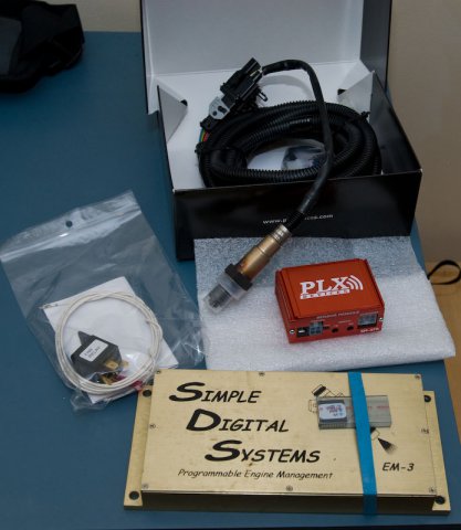

Sent out my SDS ECU for a software upgrade, nice to see I'll have the ability to log AFR's afterwards. Adding a wideband to the list of things to add this winter.
