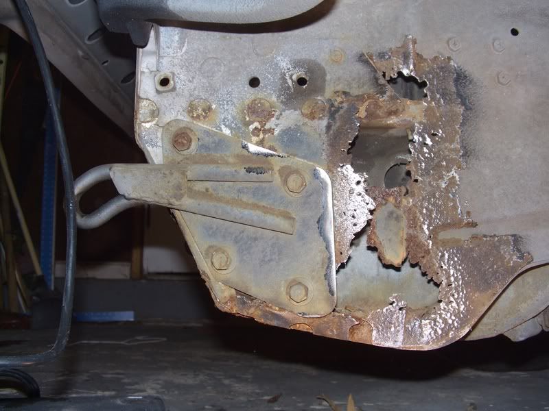

-How structural is the dog leg? I was just going to cut it out (yes, rust) and work some metal in there to look nice but will basic welding work or do I need to make it structurally sound?

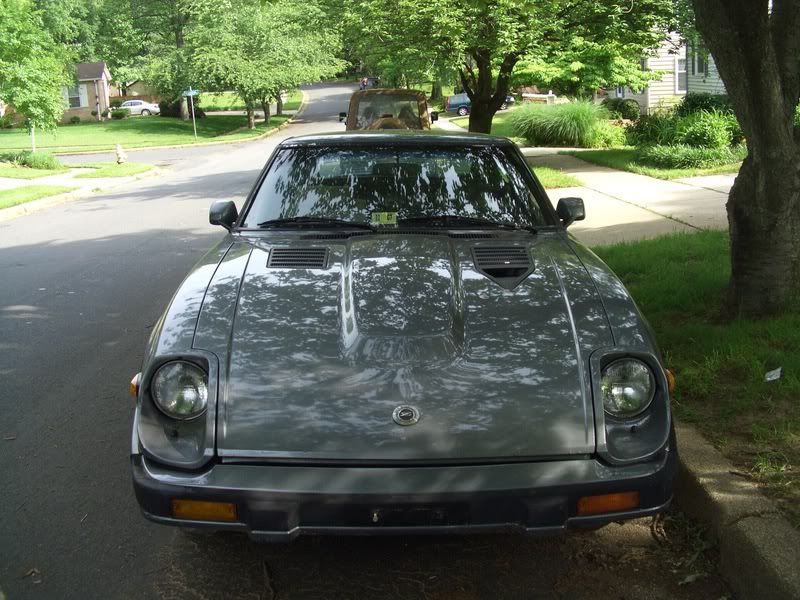

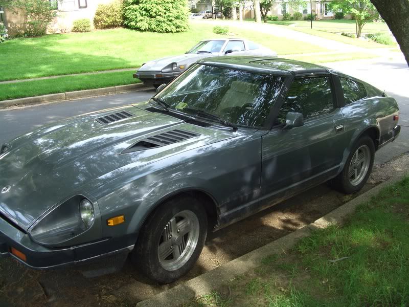

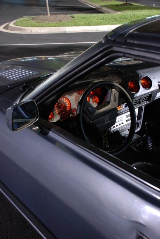

The car when I got it.

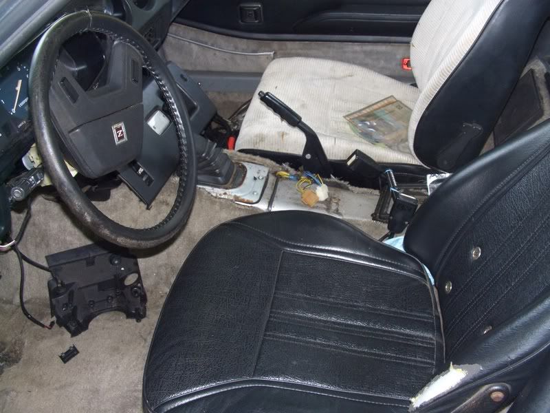

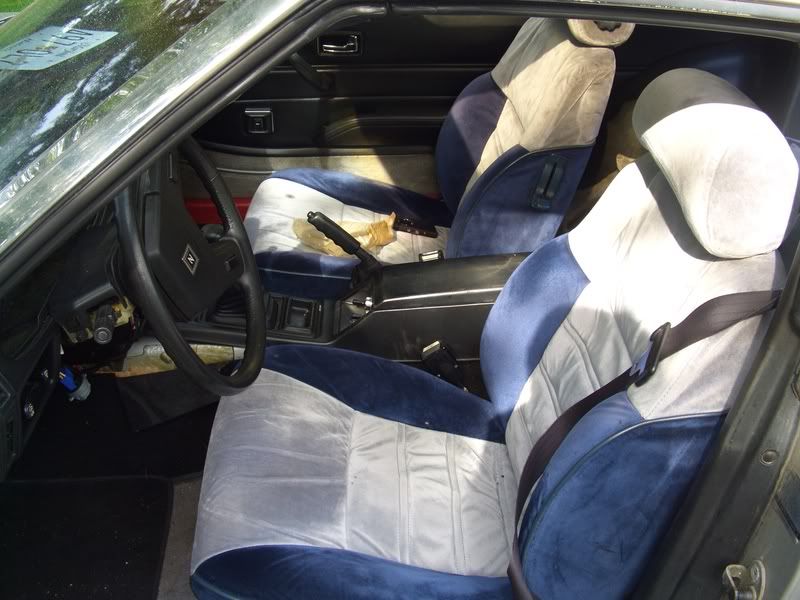

Parts car I swapped the interior from.

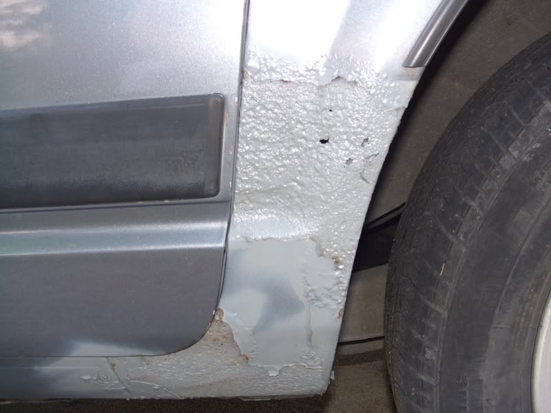

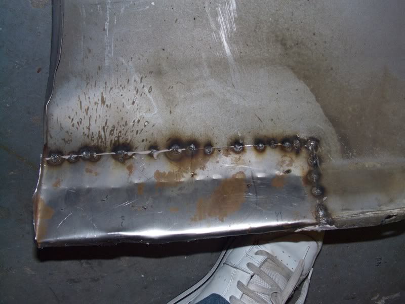

My work on the fender.
Work that needs to get done. (The other tow hook is almost as bad on the other side)

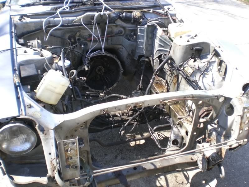

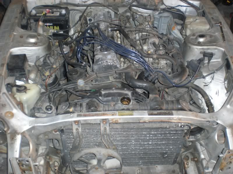

This is how the engine started out.
DAY 1.
From 8 p.m. until 6 a.m. my friend Josh who's a certified master tech (the only reason I've gotten all this done and learned so much) helped me pull the motor. He's the brains behind it but let's me do the interesting stuff or at least keeps me informed if he's doing something, so I know what's going on.
The pull went pretty dang smooth except for the very end when it was late, we were ready to be finished, and the EGR valve absolutely refused to be compliant. So we had to bust out the sawzall and dremel, and make it see things our way. So at the end of day 1 I had a complete engine on a stand in my garage and I was happy as hell.

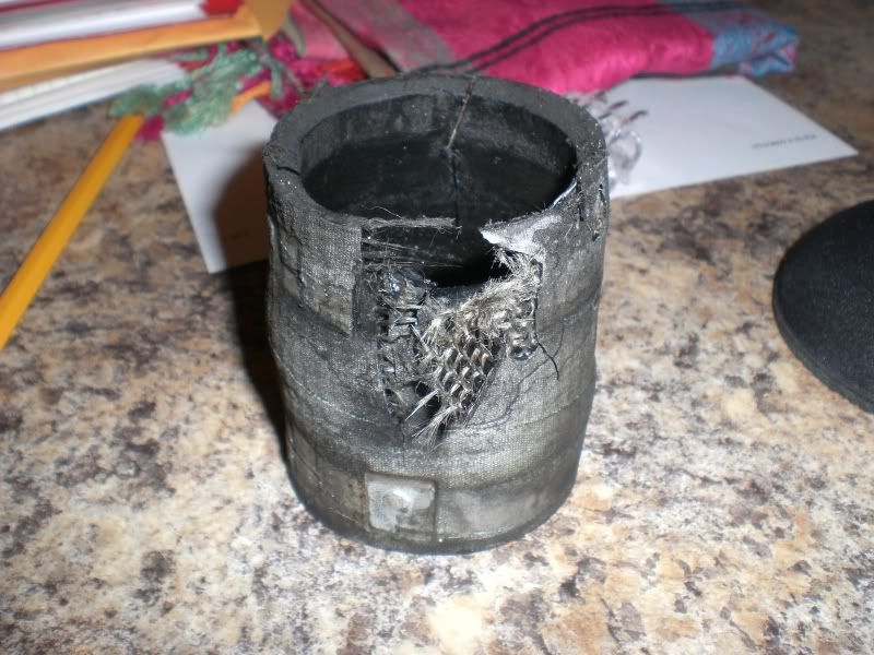

Day 2 was engine tear down and basic clean day. We stripped the engine down to the block and maybe a tid-bit or 2. We found that the clutch and turbo are in pretty good condition. In my first post I had mentioned my boost gauge only reading 2 lbs of boost. Well this along with the fast that my turbo sounded like a focused hurricane wind while spooling all started to make sense once we took things apart. This is a picture of the coupler coming directly from the turbo.
Another hose was cracked and messed up pretty badly too. This may sound like an odd thing to be very happy about but I'm assuming that by simply replacing these 2 hoses I should gain about 5 lbs of boost (up to stock 7).

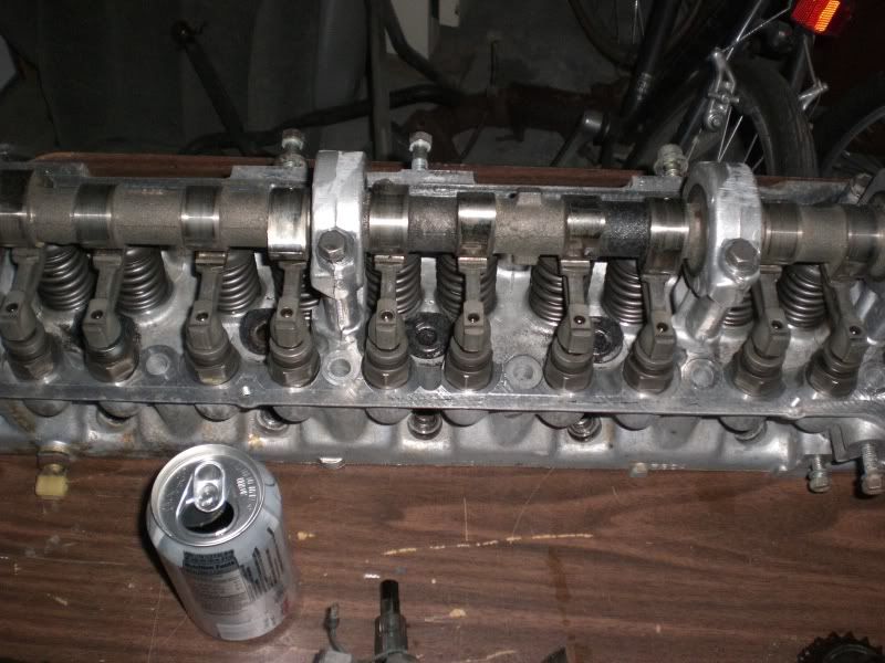

A little more about what I found in the engine. It looks like it was rebuilt a while ago and then sat for a few years. The cylinder walls still has clearly visible cross hatching, the pistons don't looks bad and there's practically no ridge at the top of the cylinder. Everything was pretty stuck together and obviously dirty which made us think it had sat for quite a while. The only bad thing we found was the bearings needed to be replaced (obviously, it's a rebuild), but on 1 or 2 of the bearings there were islands of wear, which my friend explained as most likely being caused by a lack of oil. If anybody would care to explain how this would happen please do.

Only spend about about 9 hours today instead of about 15 like yesterday but we still got a lot done. We loaded up the block, valve cover, oil pan, head, intake mani, and little bits into my car and went to the car wash with a whole load of degreaser. A few rounds of pressurewashing and scrubbing later, I looked like I got attacked by a raincloud, but I had a bunch of clean parts and I was happy. Until I got home and found there was waaay more little cleaning stuff to do. We were excited to get to the wash so we hadn't removed gaskets and the like. So the rest of the night was spent playing with razor blades and brake cleaner.
We also made a run to the store to get spray paint/self etching primer for aluminum, and clear coat once I decided on a color scheme. So here it is. Gunmetal block, cleared head, gunmetal valve cover, with hot pink Nissan TURBO. At least I didn't go with the idea of a white block as my friend is so in love with the idea of because "nobody does it". There's a reason nobody does it. But seriously, I like people to know I have fun with cars and enjoy them so I figure the pink should hint at that. So the valve cover is primed and pinked, but the gunmetal we got turned out to bed more like greenmetal. So that needs to be switched. We got through a lot of razorblades scraping, and there's just a bit left to do, then he'll bring over a compressor and cookie cutters to finish off all the gasket surfaces.
