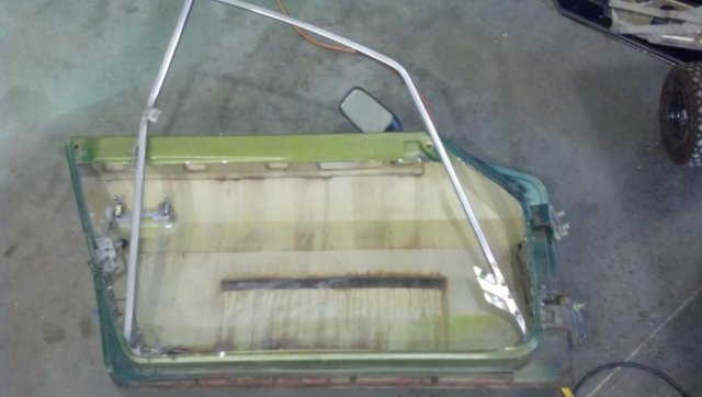

Might as well add to this old thread vs Starting new.  1973 240z on a major diet as it becomes a track only car.
Each door stock was about 66lbs if I remember (includes probably 8 coats of paint and 40 years of dried juice and jam inside there).
Drivers door getting Nascar Bars so I removed the inner beam and got a final weight of about 29lbs with hinges and the empty window frame.
They are pretty flimsly and don't close well so I will reinforce once the jungle-gym is installed.
