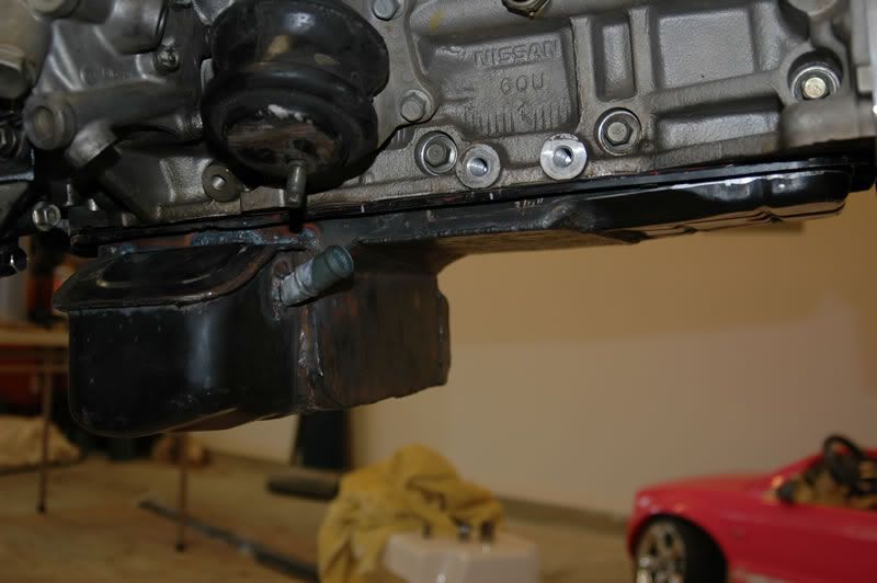

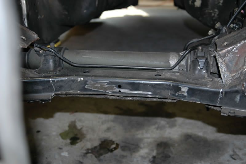

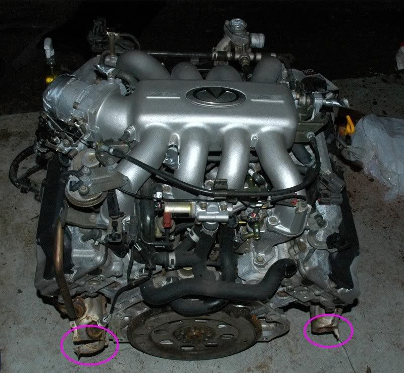

Administrators BRAAP Posted March 14, 2009 Administrators Share Posted March 14, 2009 (edited) Here's my $.02 on this. 1) I personally don’t see any really big issue between the cross member and oil pan, none that I would consider to be daunting. In fact, of ALL the engines I have stabbed into the engine bay of the Z-32 for mock up purposes, the VH45DE has to be the most natural fit, other than the hood clearance of course. The cross member forward edge needs a bit of a trim to clear the VH45 front sump. It’s not like the other V-8 swap where the rack is the in the way. To convert the VH45DE to dry sump would be a much larger project with more stumbling blocks to overcome than retaining the stock oil pan. The gentleman that took that route I think did so for other reason, not just clearance, race car if I recall. 2) Induction will be a project in of itself, yet a rewarding one. Here is thread dedicated to VH intake and exhaust design; http://forums.hybridz.org/showthread.php?t=125027 3) … 4) My bone stock ’96 Q-45, (VH45DE was bone stock, from the dirty OE air filter to the stock chrome exhaust tips) put down 242 HP to the wheels on the Dyno at Torque freaks, through the automatic. That is approx 300 crank HP, which falls inline with reports from others, (apparently Infiniti underrated the engine with their claim of only 278 HP). After I removed the VH45DE from my Q ship, I was amazed at how small the collectors were in the exhaust. Measured exactly 1.70” ID, (circled in MAGENTA in the first pic below) With a tubular header with at least 2” collectors, more like 2 ¼” or 2 ½” collectors, that alone should uncork considerably more power! 5) Not sure how much boost it can safely handle with out replacing the internals, (assuming a good safe fuel and ignition tune of course). I would venture to guess that 5 lbs of boost would be safe, so long as you were spot on with your fuel and ignition tune. Oil pan and cross member mods. These 2 pics show slightly modified pan with trimmed cross member. Courtesy NiCO forums This picture shows a cross member with more modification, one that might clear the stock 100% just fine, (This Z-32 now has a turbo LT1 in it) :2thums: Courtesy of DTS. Edited March 14, 2009 by BRAAP Quote Link to comment Share on other sites More sharing options...
Crash Posted March 14, 2009 Author Share Posted March 14, 2009 Very cool. Thanks for the info. The third question is mostly about the powersteering pump not clearing the sway bar. I've never dealt with Dry Sump so I was wondering how that might help, but I see that the x-member really isn't a big deal at all. Not a lot of modding was required there. So, what I'm seeing with the oil pan is that you cut away about 50% of the sump and simply welded some sheet metal there? That's pretty cool. I'm assuming that's about a little more than 1 qt less oil? 5Lbs of boost isn't really a lot. Makes me think the turbos I was looking at are just WAY too much, and I could get away with much smaller turbos, but that wouldn't make sense, so strengthening the internals would be the best bet. I'd like to put about 12Lbs of boost or more. Lowering the compression may be a must. But who tunes these motors? Yeah, I'm going to have custom headers made by my exhaust guy. If I go with a turbo, he'll make the manifolds. I'll likely be mounting them where the stock TT intercoolers were and use a front mount double pass intercooler. But that's just one possibility. Again, thanks for the info. Got any idea about the powersteering? Was that a problem on your swap? Quote Link to comment Share on other sites More sharing options...
Administrators BRAAP Posted March 15, 2009 Administrators Share Posted March 15, 2009 Sorry if my post and those pictures made it look as though I did the swap. Those pics are not mine, I did not do a VH45DE Z-32 conversion. I did "set" my VH45DE in the engine bay of my Z-32 mock up mule and my findings matched those pictured. I decided on installing an LSx and 6 speed in my Z-32, and sold the VH45DE. (my thread with various engines "set" in the engine bay of the Z-32 including the VH45DE) http://forums.hybridz.org/showthread.php?t=142025 I feel the oil pan does not need to be cut like that to fit if the cross-member is modified. As for the power steering? Sorry I have no input on that. Quote Link to comment Share on other sites More sharing options...
