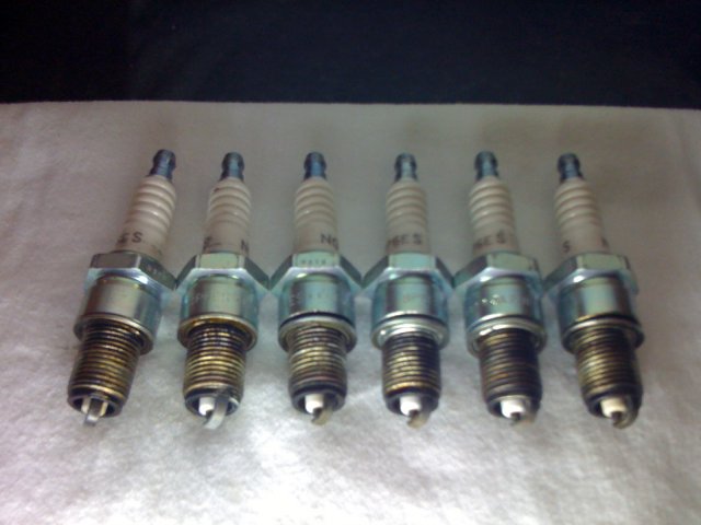

I'll try and get a picture of a plug electrode for you tonight, they look pretty good (slightly rich) and I'm sure I need to go through and dial the carb in as I believe the PO just installed it out of the box. I will be searching for tune up procedures for the Holley as I am not familiar with this carb...YET.

Here are a couple of photos of the plugs as removed. They are not the best pictures as I had to use my phone, I'll pick up my camera and get some better ones this afternoon.
The are lined up in order with #1 far left in the picture.

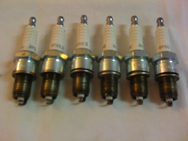

No problem Daniel, I'm glad I am of some help to you.
Your plugs look good from what I can see. You know your carb is working reasonably well then.
