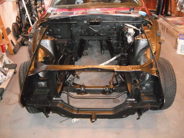

Beau M Posted September 28, 2009 Author Share Posted September 28, 2009 I made a little more progress today. I borrowed a pressure washer and went to town on the front end of the car. After a few sessions it cleaned up pretty good. I then sprayed the wheel wells with rubberized undercoating, and will be painting the engine bay in the next few days I hope. Quote Link to comment Share on other sites More sharing options...
Beau M Posted October 5, 2009 Author Share Posted October 5, 2009 Threw some paint in the engine bay. I was going to do it red, but I figured there would be no way I could match the exterior color. So I said F it and went with semi-gloss black. Quote Link to comment Share on other sites More sharing options...

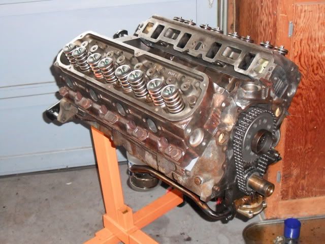

Beau M Posted November 13, 2009 Author Share Posted November 13, 2009 Just a little update. I got the valve springs I needed to upgrade my Explorer heads. Apparently with the stock springs the heads will get valve float around 5K RPM. These Trick Flow springs will fix that. One old, one new: New Hotness: Quote Link to comment Share on other sites More sharing options...
Beau M Posted November 22, 2009 Author Share Posted November 22, 2009 Progress! First, I got a new timing chain: Next I got some gaskets and slapped the heads back on: Then I masked it off, and painted the block: I took my intake and timing cover to the machinist to get cleaned, then painted them with the same paint I used on the transmission. I guess its alright. I am going for a red-white-blue theme with the engine, so being a little more shiny works. The oil pan got a coat of Ford blue. All new gaskets and bolts all around. Next step is some valve covers and a harmonic dampener. Quote Link to comment Share on other sites More sharing options...

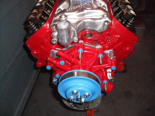

Beau M Posted November 28, 2009 Author Share Posted November 28, 2009 I got a new water pump and made it all fancy. Not much to say about it, but I think its looking good. Quote Link to comment Share on other sites More sharing options...

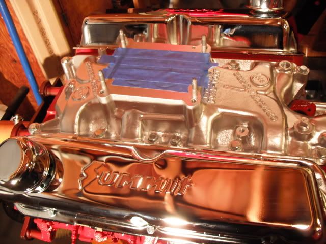

Beau M Posted December 3, 2009 Author Share Posted December 3, 2009 I got some shiny parts in last night. I took these pictures at night, but you get the idea. I was leery of getting the ones with the Summit logo, but I like them now. Quote Link to comment Share on other sites More sharing options...

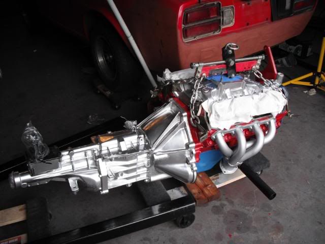

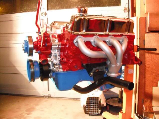

Beau M Posted December 16, 2009 Author Share Posted December 16, 2009 Santa came to my house a little early this year. I got a lot of new parts, I'm pretty excited. OK, here is the first batch: A new clutch from e-bay, tranny mount from JTR, and re-surfaced flywheel fresh from the machine shop: Because I have a ford drive train and the tranny mount is for a chevy, I had to enlarge the hole in the mount. Not terribly difficult, and should give me an inch or two play with side to side. Also painted it red, so its faster. I also got some headers from Speedway Motors. I really hope they fit, they are block huggers and work with my GT40p heads, which is kind of hard to find. Here they are raw: I cleaned them up with a wire wheel and some acetone, then shot some silver VHT high temp paint on them. I hope it does what it's supposed to and hold up to the heat, but I am skeptical. Quote Link to comment Share on other sites More sharing options...

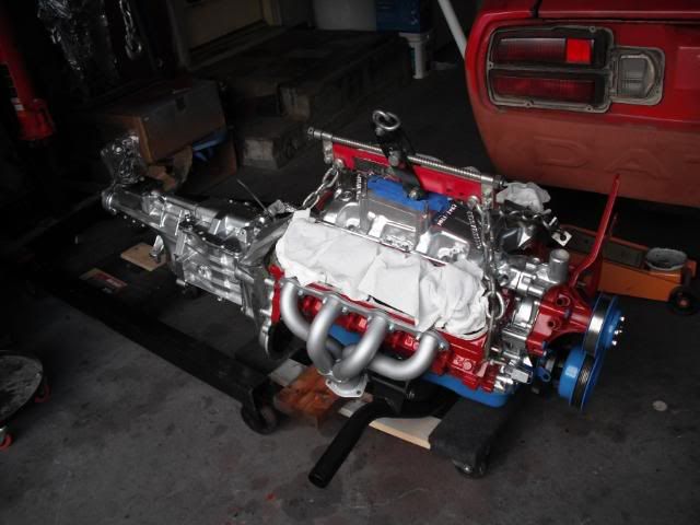

Beau M Posted December 16, 2009 Author Share Posted December 16, 2009 I got a universal 302 cross member and some rubber engine mounts from Speedway Motors. In theory, I should be able to cut the member the width of the frame rails, slip it in and weld it up. I have a feeling the steering shaft and headers are going to complicate things. I bought a new harmonic dampener and threw that on, along with another blue pulley. Here are a bunch of pics of the mount mocked up to the engine with the headers on: So, I think I almost have everything I need to try and stab this thing into the car. It won't be hooked up or anything, but having the engine in the car will be a huge step and morale boost. Quote Link to comment Share on other sites More sharing options...
Beau M Posted December 20, 2009 Author Share Posted December 20, 2009 Just a little update. I put the new clutch in and the tranny on. This was my first clutch job ever, it was easier than I thought it would be and gave me a good idea of how a clutch works. Here is the flywheel bolted on with new bolts. Yes I cleaned it real good before putting the clutch disk in: I forgot to take a picture with the pressure plate on. I had to make a run to ACE for some new bolts, turns out the flywheel is metric. Anyway, here is the tranny mounted to the engine. My next steps are to cut off the transmission mount "ears" under the Z. I also have to move some hoses and lines, but then I can trial fit the engine. Things are moving along nicely lately. I really hope this thing runs Quote Link to comment Share on other sites More sharing options...

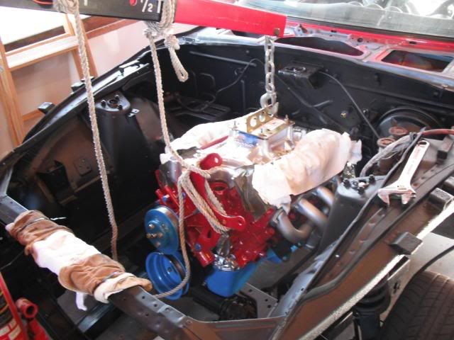

Beau M Posted January 12, 2010 Author Share Posted January 12, 2010 Ok, its about time for an update. The transmission ears had to go. Its about time I made an appearance in this thread. Here I am with the sawzall sitting where the engine should be. Here we go, back on the picker. Quote Link to comment Share on other sites More sharing options...

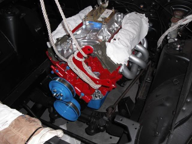

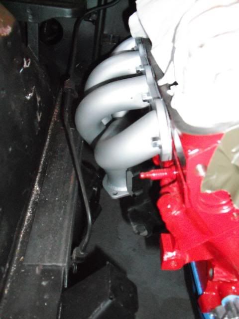

Beau M Posted January 12, 2010 Author Share Posted January 12, 2010 And she's in! There is not nearly as much room to play with as I thought there would be. Its tucked down behind the front crossover, and the balancer is about an inch above the steering rack. I see that there will be some clearance issues in a few places, such as the firewall and the tranny tunnel. The headers fit great though, and that is wonderful news. Quote Link to comment Share on other sites More sharing options...

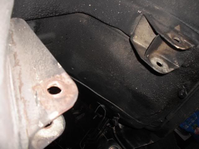

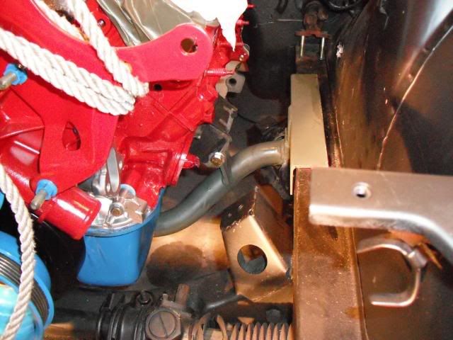

Beau M Posted January 12, 2010 Author Share Posted January 12, 2010 Here's a couple headder pics: Now for motor mounts. Ugh. My inexperience and impatience are going to show in the following pictures, but if I did something wrong and my engine falls out on the freeway its all my fault. First, I cut my new x-member in half. I got a small length of pipe with an inner diameter the same as the x-members outer diameter. This allowed me to take the x-member out in pieces. This was VERY helpful during mock-up. But, I found I had a problem. With the engine in the proper place, the points where the x-member were supposed to attach to the frame were pointing directly at the TC rod buckets. It was about 2 inches too low. Here is where not enough experience and a few too many beers comes in. I decided to cut windows in the TC buckets: Quote Link to comment Share on other sites More sharing options...
Beau M Posted January 12, 2010 Author Share Posted January 12, 2010 I used 2" angle steel, 12" long to sit on the frame rails. I then cut little 2" x 4" pieces to drop down from the angle iron into the windows I cut, which the x-member ends could connect to. Hopefully the pictures can explain it better than I. But like I said, this is probably not the best way to get this done. Here it it with the engine bolted up. The next step is to figure out a way to bolt this thing to the frame, clearance things, and re-run all the brake and fuel lines I had to cut out during the engine mock-up. Stay tuned! Quote Link to comment Share on other sites More sharing options...
