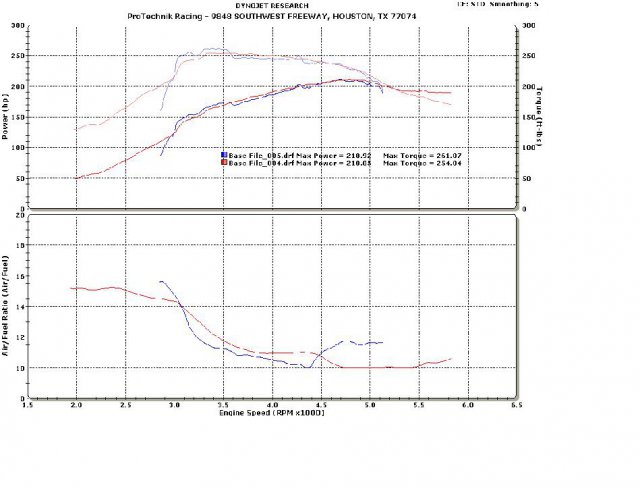

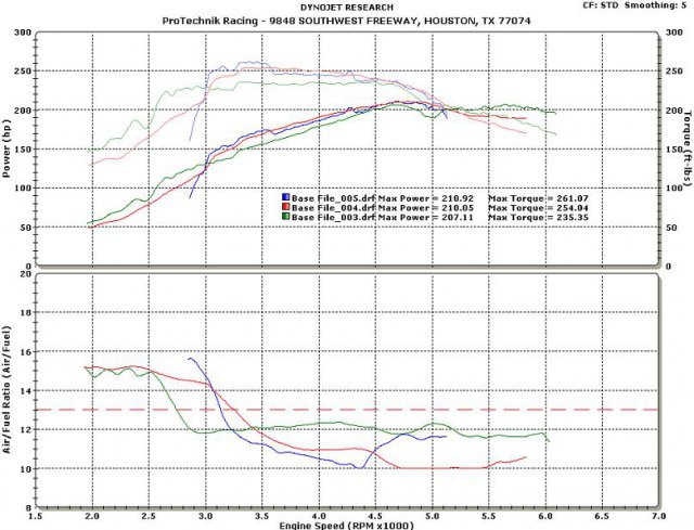

guys, i took the z to the dyno today , here are the #'s i put down.
my set up is the Jwt z31 ecu / ford cobra maf on the stock injectors. I run a z31 watercooled turbo @ 11 ish lbs. a 240 sx throttle body w/ msa custom 2 1/2 d/p all the way back to borla pro x/s muffler.
I don't run an intercooler yet, but that's my next step.
my best run was @ 10 lbs.
my question is ,, when i cranked the boost to 15 lbs, the engine took it, but based on the read out, i lost hp because the engine was running rich... would i stand to gain h/p if i kept running 15 lbs and put an adjustable fuel pressure regulator in line with the stock one ?
also, any pointers to help me comprehend the information here as i am still learning all the turbo info.
